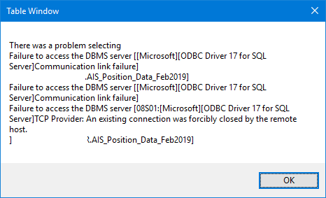

However, when I imported that large data set into our enterprise geodatabase (so I could get it ready for publishing), and then opened the attribute table to make sure all of the records were there, I suddenly started to run into ODBC driver connection errors, as per below:

So does this ODBC Driver 17 failure mean that the enterprise geodatabase has limitations, or is there perhaps a way I can fix this? I'm also wondering if I could just put this data set into a registered folder on our server and then add it to Portal that way instead.
