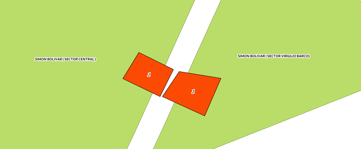

In the new version of ArcGIS Server 10.6 it is not possible to request GetFeature WFS with spatial filters with multi-surface geometry. The following is an example of the query:
GML3 geometry would be represented as:
<SPAN class="token tag"><SPAN class="token tag"><SPAN class="punctuation token"><</SPAN><SPAN class="namespace token">gml:</SPAN>MultiSurface</SPAN> <SPAN class="attr-name token">srsName</SPAN><SPAN class="attr-value token"><SPAN class="punctuation token">=</SPAN><SPAN class="punctuation token">"</SPAN>urn:ogc:def:crs:EPSG:6.9:6247<SPAN class="punctuation token">"</SPAN></SPAN><SPAN class="punctuation token">></SPAN></SPAN><SPAN class="token tag"><SPAN class="token tag"><SPAN class="punctuation token"><</SPAN><SPAN class="namespace token">gml:</SPAN>surfaceMember</SPAN><SPAN class="punctuation token">></SPAN></SPAN><SPAN class="token tag"><SPAN class="token tag"><SPAN class="punctuation token"><</SPAN><SPAN class="namespace token">gml:</SPAN>Polygon</SPAN><SPAN class="punctuation token">></SPAN></SPAN><SPAN class="token tag"><SPAN class="token tag"><SPAN class="punctuation token"><</SPAN><SPAN class="namespace token">gml:</SPAN>exterior</SPAN><SPAN class="punctuation token">></SPAN></SPAN><SPAN class="token tag"><SPAN class="token tag"><SPAN class="punctuation token"><</SPAN><SPAN class="namespace token">gml:</SPAN>LinearRing</SPAN><SPAN class="punctuation token">></SPAN></SPAN><SPAN class="token tag"><SPAN class="token tag"><SPAN class="punctuation token"><</SPAN><SPAN class="namespace token">gml:</SPAN>posList</SPAN><SPAN class="punctuation token">></SPAN></SPAN>98465.5842225004 106542.564601002 98498.638362525 106596.879798651 98570.0738671067 106561.465944204 98542.3330263732 106505.380223682 98465.5842225004 106542.564601002<SPAN class="token tag"><SPAN class="token tag"><SPAN class="punctuation token"></</SPAN><SPAN class="namespace token">gml:</SPAN>posList</SPAN><SPAN class="punctuation token">></SPAN></SPAN><SPAN class="token tag"><SPAN class="token tag"><SPAN class="punctuation token"></</SPAN><SPAN class="namespace token">gml:</SPAN>LinearRing</SPAN><SPAN class="punctuation token">></SPAN></SPAN><SPAN class="token tag"><SPAN class="token tag"><SPAN class="punctuation token"></</SPAN><SPAN class="namespace token">gml:</SPAN>exterior</SPAN><SPAN class="punctuation token">></SPAN></SPAN><SPAN class="token tag"><SPAN class="token tag"><SPAN class="punctuation token"></</SPAN><SPAN class="namespace token">gml:</SPAN>Polygon</SPAN><SPAN class="punctuation token">></SPAN></SPAN><SPAN class="token tag"><SPAN class="token tag"><SPAN class="punctuation token"></</SPAN><SPAN class="namespace token">gml:</SPAN>surfaceMember</SPAN><SPAN class="punctuation token">></SPAN></SPAN><SPAN class="token tag"><SPAN class="token tag"><SPAN class="punctuation token"><</SPAN><SPAN class="namespace token">gml:</SPAN>surfaceMember</SPAN><SPAN class="punctuation token">></SPAN></SPAN><SPAN class="token tag"><SPAN class="token tag"><SPAN class="punctuation token"><</SPAN><SPAN class="namespace token">gml:</SPAN>Polygon</SPAN><SPAN class="punctuation token">></SPAN></SPAN><SPAN class="token tag"><SPAN class="token tag"><SPAN class="punctuation token"><</SPAN><SPAN class="namespace token">gml:</SPAN>exterior</SPAN><SPAN class="punctuation token">></SPAN></SPAN><SPAN class="token tag"><SPAN class="token tag"><SPAN class="punctuation token"><</SPAN><SPAN class="namespace token">gml:</SPAN>LinearRing</SPAN><SPAN class="punctuation token">></SPAN></SPAN><SPAN class="token tag"><SPAN class="token tag"><SPAN class="punctuation token"><</SPAN><SPAN class="namespace token">gml:</SPAN>posList</SPAN><SPAN class="punctuation token">></SPAN></SPAN>98547.0558057572 106505.380685821 98581.8812200508 106557.334667689 98668.0733316556 106543.174764104 98634.4311531541 106465.24560996 98547.0558057572 106505.380685821<SPAN class="token tag"><SPAN class="token tag"><SPAN class="punctuation token"></</SPAN><SPAN class="namespace token">gml:</SPAN>posList</SPAN><SPAN class="punctuation token">></SPAN></SPAN><SPAN class="token tag"><SPAN class="token tag"><SPAN class="punctuation token"></</SPAN><SPAN class="namespace token">gml:</SPAN>LinearRing</SPAN><SPAN class="punctuation token">></SPAN></SPAN><SPAN class="token tag"><SPAN class="token tag"><SPAN class="punctuation token"></</SPAN><SPAN class="namespace token">gml:</SPAN>exterior</SPAN><SPAN class="punctuation token">></SPAN></SPAN><SPAN class="token tag"><SPAN class="token tag"><SPAN class="punctuation token"></</SPAN><SPAN class="namespace token">gml:</SPAN>Polygon</SPAN><SPAN class="punctuation token">></SPAN></SPAN><SPAN class="token tag"><SPAN class="token tag"><SPAN class="punctuation token"></</SPAN><SPAN class="namespace token">gml:</SPAN>surfaceMember</SPAN><SPAN class="punctuation token">></SPAN></SPAN></gml:MultiSurface<SPAN class="line-numbers-rows"><SPAN></SPAN></SPAN>
The POST query for the following case would be as follows:
