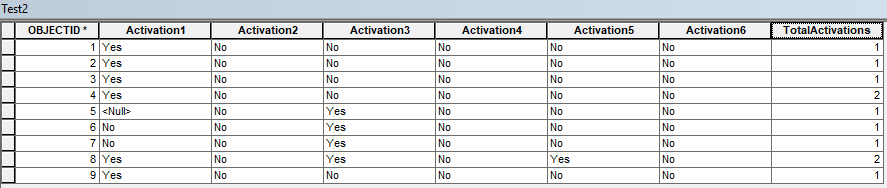

I am new to using attribute assistant and need some help. I need to be able to populate a field on the fly called Total Activations (field name TotalActivations) based on Activation1, Activation2, Activation3, Activation4, Activation5, and Activation6.
I can create a script in Python to do this, but not sure how to do it in Attribute Assistant. The reason why i would like to use Attribute Assistant is so that an user does not have to run a script tool every time an update is made. Here is what my table looks like:
If the value is 'Yes' in any of the activation numbered fields, that takes the value of 1, any 'No' or <Null> values takes a value of 0. So the first line item would total 1.
