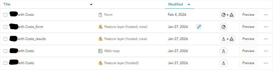

Hi Survey123 Users,
I am creating a new public survey using Survey123 Connect and I want to make sure the data being recorded is secure.
I have followed @IsmaelChivite's blog https://community.esri.com/t5/arcgis-survey123-blog/securing-data-in-public-surveys-survey123-connect/ba-p/898436 but since it was written, Survey123 Connect made some changes.
The folder contents of my survey and sharing levels after following the steps of the blog are shown below;
The submission_url pasted in the survey's .xlsx spreadsheet is linked to the feature layer (hosted, view) "..._form".
Does this set up look right for a public survey with secure records? I'm unsure about the feature layer (hosted, view) "..._form" being shared publicly. Public Data Collection has also been toggled on for this layer which I'm not sure about either... but every time I follow the steps in the blog, this is the sharing I end up with.
Any comments would be much appreciated.
