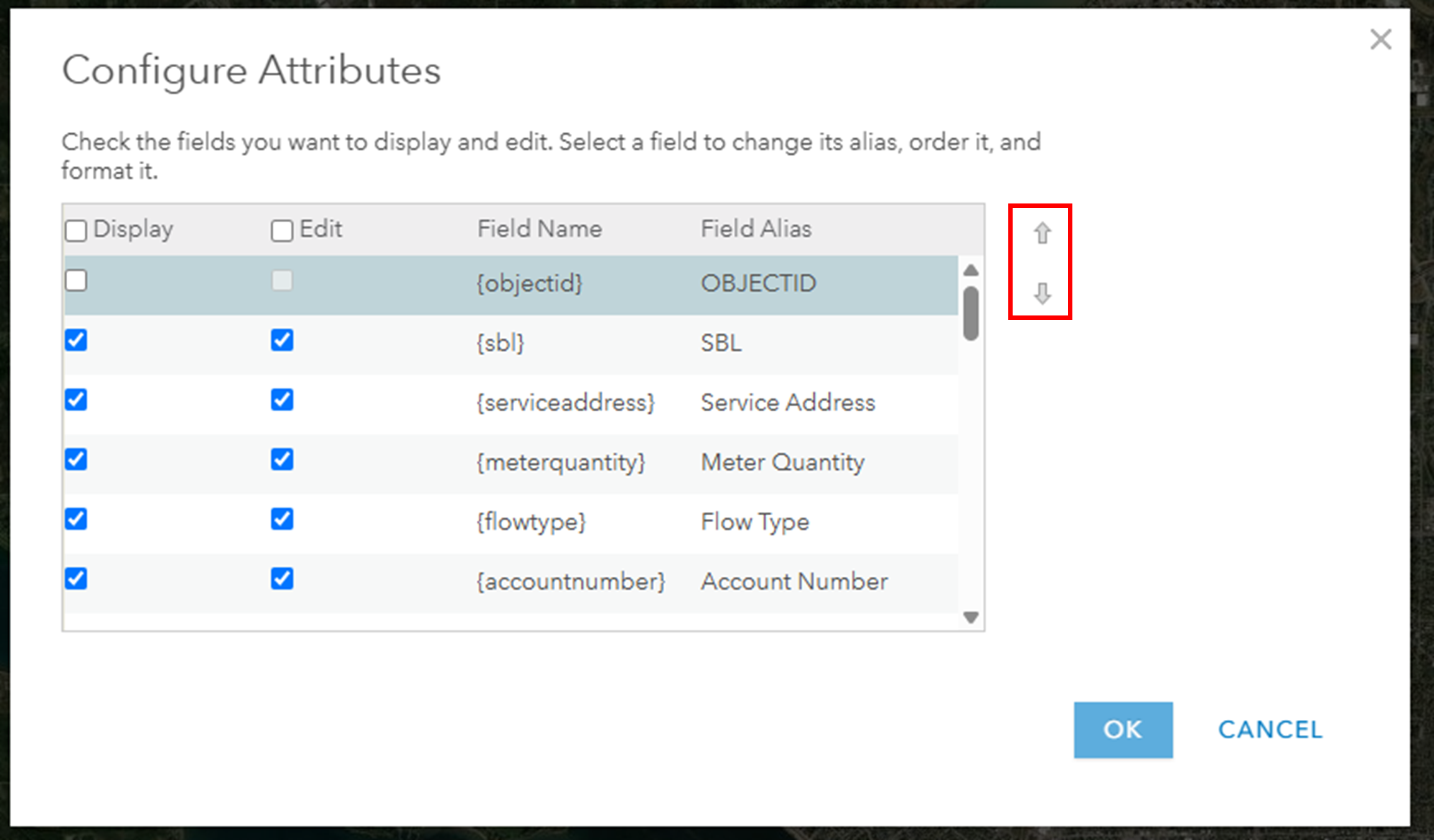

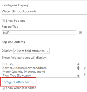

In Map Viewer Classic, you can control/edit the pop-up field order, the editing fields, and the attribute table fields all from the "configure attributes" setting.
In Map Viewer, these are all controlled separately, with no option to customize the attribute table field order. Currently, the only way (not really a workaround or a solution) to rearrange your attribute field order in Map Viewer, is to reorder your feature layer fields in ArcGIS Pro and overwrite the web layer.
