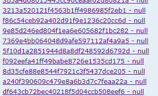

I have removed these services in ArcGIS server manager but some service item folders were not removed completely in portal folder and they were still picked up in below rest service.
https://portal/sharing/rest/content/users/USER_NAME/
I have followed below steps and restarted Portal and ArcGIS sevices.
https://support.esri.com/en/technical-article/000016345
What I see now is null for the services I have removed.
How can I delete them completely from our system?
