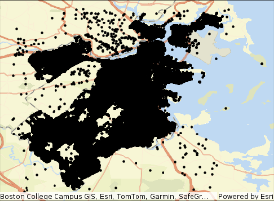

This dataset is fairly large - more than 24 million records! With large datasets, it is often difficult to visually identify patterns in the data by just looking at the data.
GeoAnalytics for Fabric can make it easier to explore these patterns through aggregation and other analytic techniques that we will explore in this post. Not only does it make it easier to see the patterns within your notebook experience, data aggregation is often an important step in preparing data for exploration in common business intelligence tools, like Power BI.

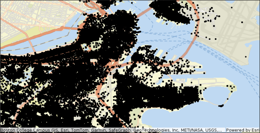

It is common with point datasets to have enough data that the points on the map overlap and hide patterns in the distribution. This happens because the points overlap enough that you cannot visually identify the density - if the whole map is fully covered with data markers, there is no pattern other than a fully covered map.
Spatial aggregation can be useful in these cases to make it easier to identify general spatial patterns in point datasets. Spatial aggregation allows you to count up the number of points that fall into discrete geographic regions (e.g., squares, hexagons, school districts, census tracts, etc.) and then map the counts of points, or other aggregates of the attributes, into each of these polygons.
In addition to identifying spatial patterns by aggregating the data, this also helps for creating datasets for BI tools, like Power BI to more easily visualize the data in dashboards.
As we saw in the plot of our dataset above, there really is too much data to be able to clearly see a pattern. Even if we zoom in fairly closely, we still might have trouble with seeing patterns in this dense dataset. So, let's explore how spatial binning and aggregation can help.

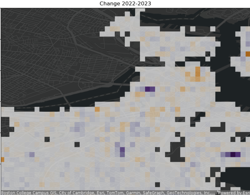

We can also use these results to calculate change over time for results like this:

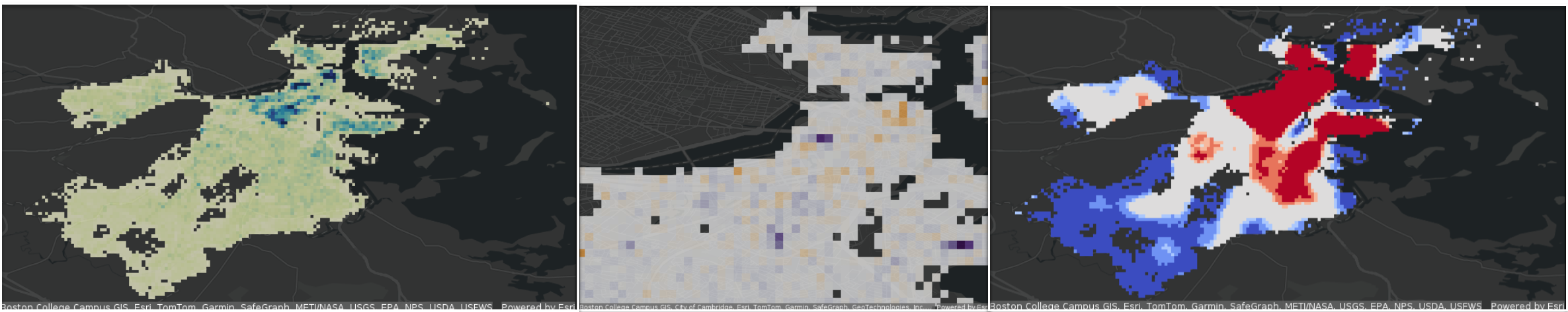

The results can be plotted and examined to see the areas where there are significantly more or fewer calls than the surroundings.
