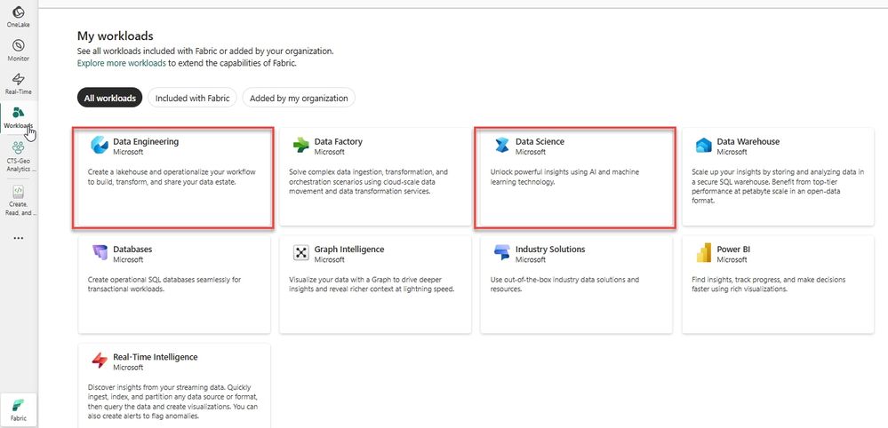

Where can you use GeoAnalytics for Fabric
GeoAnalytics for Fabric is accessible in the Data Science and Data Engineering workloads within Fabric.  In these workloads, you'll be able to work with GeoAnalytics for Fabric within notebooks.  The library is only included in the Microsoft Fabric Runtime 1.3.  It is not included in earlier runtimes.
Fabric data science and data engineering workloadsFabric data science and data engineering workloads

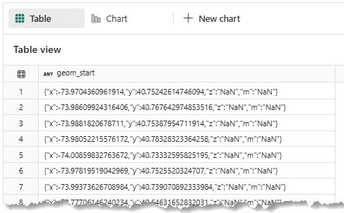

Once we create our geometry column using ST_Point, we have a new column that looks like the table below. Note that by default GeoAnalytics for Fabric will display the geometry in a human-readable format to make it easier to get a feel for what is in the column when you display it.  You may also notice that there are NaN for the "z" and "m" elements in the point.  This is because ST_Point only takes X and Y coordinates as input, but a point geometry can also store values for "m" (measure) and "z" (3rd dimension) elements.
One column of point geometry dataOne column of point geometry data
Now that we have a point geometry, we can map it or use it in our analyses.

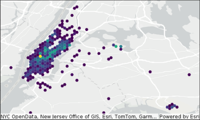

Or we can perform any number of analyses using the functions and tools available in GeoAnalytics for Fabric.  For instance, we could create hexagonal bins to explore the data distribution visually - or to simplify to incorporate into a Power BI dashboard. For instance, we can use the aggregate points tool:
from geoanalytics_fabric.tools import AggregatePoints
# Use Aggregate Points to summarize the count of taxi pickups
result = AggregatePoints() \
            .setBins(bin_size=0.5, bin_size_unit="Kilometers", bin_type="Hexagon") \
            .run(df)
result.st.plot(basemap="light", cmap_values="count")

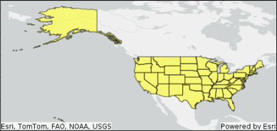

As an example, we can read a feature service with USA States Generalized Boundaries from the ArcGIS Living Atlas like this - the URL for the feature service comes from the details page for the feature:
# read a feature service hosted in the Living Atlas of the World
myFS="https://services.arcgis.com/P3ePLMYs2RVChkJx/arcgis/rest/services/USA_States_Generalized_Boundaries/FeatureServer/0"
df = spark.read.format('feature-service').load(myFS)
# plot a DataFrame with geometry from a feature service
df.st.plot(basemap="light", facecolor="yellow", edgecolor="black", alpha=0.5);

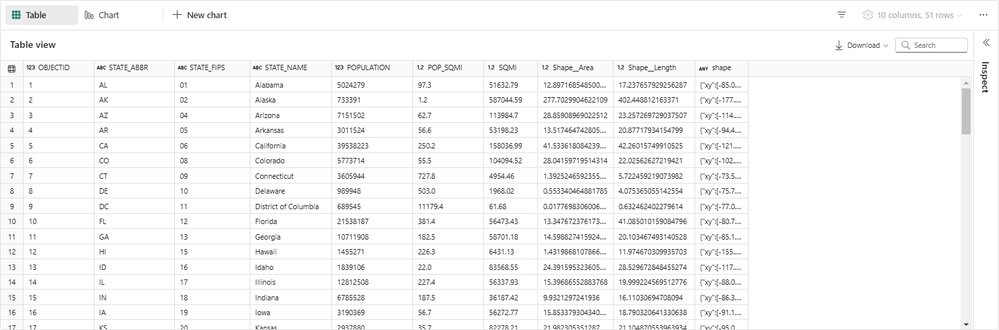

The feature service shown above has numerous attributes, including the polygon geometry that we used to plot the map.
