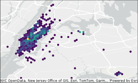

Note that in the Public Preview, to render basemaps you need to include a special configuration cell at the start of your notebooks. More detail is provided in the Known Limitations post in the GeoAnalytics for Fabric Community.
Or we can perform any number of analyses using the functions and tools available in GeoAnalytics for Fabric. For instance, we could create hexagonal bins to explore the data distribution visually - or to simplify to incorporate into a Power BI dashboard. For instance, we can use the aggregate points tool:
from geoanalytics_fabric.tools import AggregatePoints
# Use Aggregate Points to summarize the count of taxi pickups
result = AggregatePoints() \
.setBins(bin_size=0.5, bin_size_unit="Kilometers", bin_type="Hexagon") \
.run(df)
result.st.plot(basemap="light", cmap_values="count")

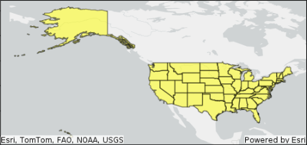

As an example, we can read a feature service with USA States Generalized Boundaries from the ArcGIS Living Atlas like this - the URL for the feature service comes from the details page for the feature:
# read a feature service hosted in the Living Atlas of the World
myFS="https://services.arcgis.com/P3ePLMYs2RVChkJx/arcgis/rest/services/USA_States_Generalized_Boundaries/FeatureServer/0"
df = spark.read.format('feature-service').load(myFS)
# plot a DataFrame with geometry from a feature service
df.st.plot(basemap="light", facecolor="yellow", edgecolor="black", alpha=0.5);

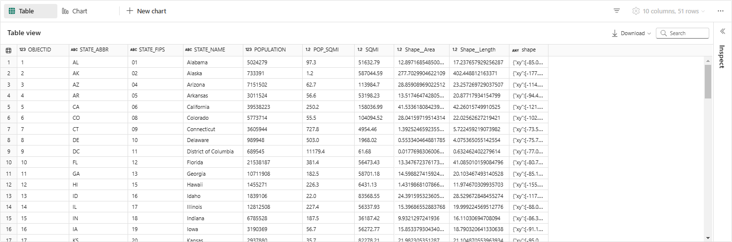

The feature service shown above has numerous attributes, including the polygon geometry that we used to plot the map.
