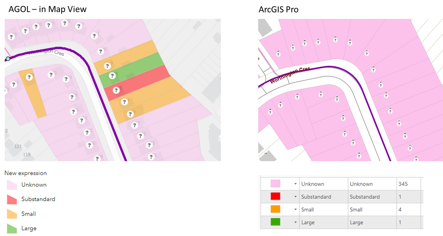

Now it works perfectly fine in AGOL when I view it in Map Viewer, that when I update feature values in address points layer, the visualization of the parcels in the hosted view updates as well (not immediately though, some zooming in and out to force refreshing which is annoying). BUT!! When I add this hosted view to ArcGIS Pro project, it does not draw the colours according to the symbology, but only draws one colour!! See screenshot that illustrates what I see in AGOL vs ArcGIS Pro.
