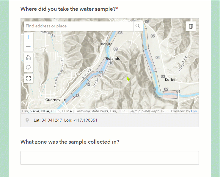

Sometimes there is information on the map that you’d like to capture with your survey result. In this example, students are capturing water quality samples along the river, and you've divided the river into zones. In the survey, have the map provide the zone as an answer in the survey instead of having students enter it.
While students could fill out the zone, there is no need for them to and it can introduce human error. You could get a sample that says it was taken in Zone 03, but the point on the map is in Zone 05. Which is correct – the point or the zone? Avoid this type of error by reading the zone from the map directly into your survey.
To read the zone from a layer and put it into a question, add a question to record the zone and configure it to use a calculation based on the map. Watch the video below or follow the text steps below the video to configure this behavior in a survey:

- Below Select output field choose the name of the field that will populate the survey.
- For Set filter, enable Extract data by location and select the map in your survey. This means the location set on the map will be used to find the data from the layer.
- Click OK to complete configuration of the question.
