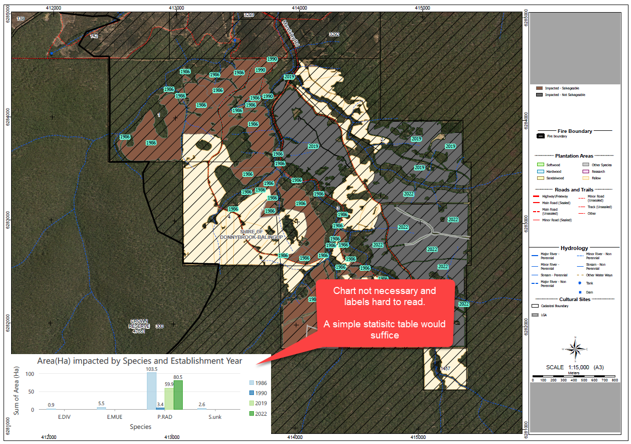

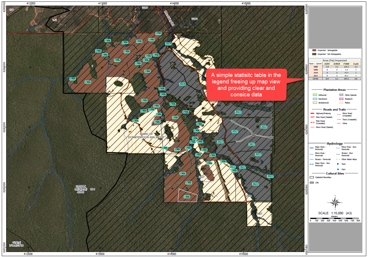

We have many map layouts where we display summarised data from layers within the maps (usually summaries of area by tree species or planting year for example). Currently we have to include these stats as bar charts, and while this works, a lot of the time, the chart part of the solution is unnecessary. We would much prefer a dynamic table summary where we select a category for the rows and/or columns and a calculated total for a numeric field is displayed (essentially like building pivot tables in Excel). These charts could save a lot of real estate on layouts that have a lot going on and where a whole chart is unnecessary. Some examples below:
Current Map Layout:
Desired Layout option:
