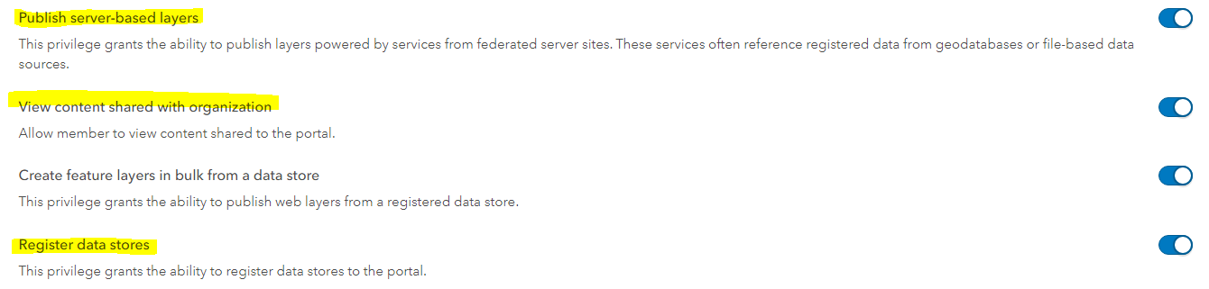

Hi there,
We have a map built in our Portal 10.9.1 system which containers registered layers which are published from our Enterprise geodatabase. This map and its layers are shared to the entire organization.
Only I (on a custom role with high privileges), and the admin account can view all the layers correctly in the web map. However other organization members (on Viewer roles) can only view the non-registered layers in the map. It does not prompt an error message; it just gets stuck on infinite loading.
Having looked at the member role permissions, I can only see the highlighted below which mention publishing referenced content. Is there a particular permission which is needed for users to view these registered layers? I assumed that because they are shared organization wide that they would be able to view these.
