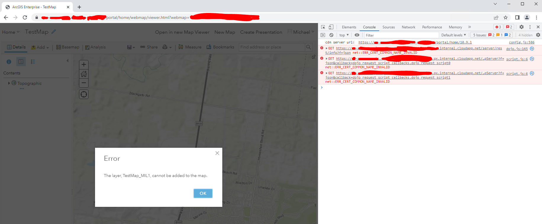

I've created an ArcGIS Enterprise install (server, portal, two webadaptors, datastore, all on the same machine) and have just tried publishing a webmap to it from ArcGIS Pro. This worked fine. However, when I come to access it, I'm getting this error:
Does anyone have any idea for this one? Obviously it's pointing at certificates, and I believe they're all set up (it's pointing to my machine.domain.com as the CN - so that would be without a https:// or port).
One thing I am thinking is this could be because I've got a hyphen in the machine name (also in the domain, but looking at the GET requests the domain is being substituted for something else), and a few posts I've looked at indicate that ArcGIS Server doesn't like having numbers in the machine/domain. I wonder if it's the same for hyphens...

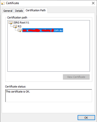

EDIT - incidentally, I'm just looking at my certification path and noticed that I've got two certificates above mine. Would these both need to be imported into Portal (and whatever else)? If so, where would they need to go?
