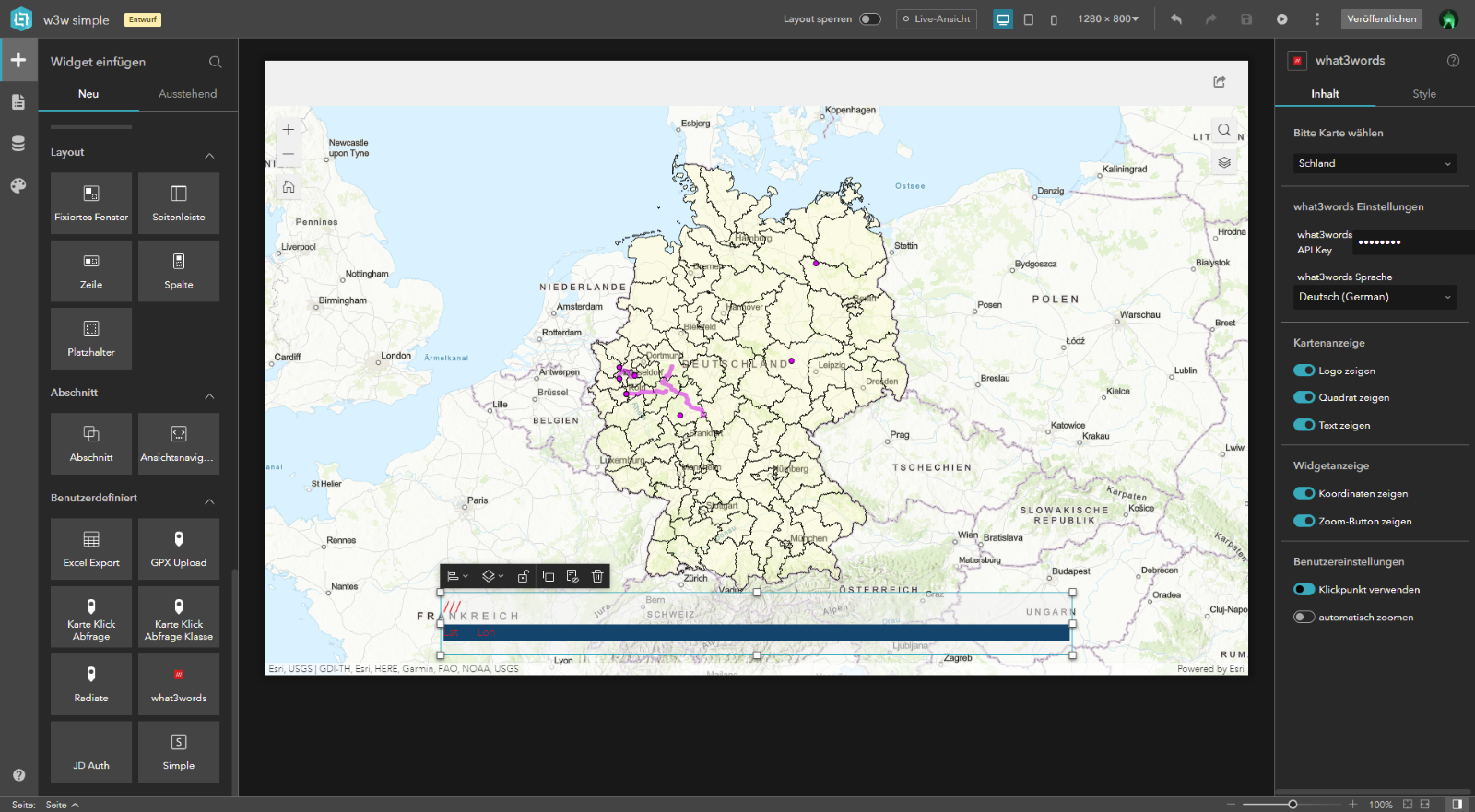

The what3words-Widget in an ArcGIS Experience
Now we need to know how to easily integrate the system into a web application. Fortunately, the ArcGIS Experience Builder Developer Edition is an extensible, configurable WYSIWYG application for WebGIS apps. The Experience Builder runs on the JavaScript-based server Node.js, which brings the Node Package Manager (NPM) to load external dependencies from the Internet. A package just like this is provided by what3words to use its REST API. We took advantage of this to develop a widget, which is freely available on GitHub.
Clicking on the map sends the click point as a coordinate to the REST API and gets back a response object in GeoJSON format containing the vertices of the square and of course the three-word address, among other information. From this response, the square is drawn on the map and the widget is filled with data. The wrapper in the NPM package of what3words is mostly correctly typed and is therefore comfortable to use with TypeScript. Here is a snippet from the TypeScript Definitions that defines the response object:

In the backend of the Experience Builder, which is the configuration page used to assemble your app out of data sources and widgets, the what3words widget offers a wide range setting options. As usual, a connection to a map widget needs to be established in order to retrieve the click point and visible extent and to draw on the map in return. The aforementioned API Key is stored here and used in the background for every request to the REST API.
When the backend is initialized, it queries the shortcodes of all available languages at what3words. The setting affects the language of the three-word address on the widget and on the map. Other settings are related to the map display as well as the widget display and behavior.
The REST API provides a function to return the grid, but in maximum 4x4 km size. The widget reacts to the zoom level of the map view and checks the geodesic distance of two vertices in larger scales. If it falls below 4 km, the grid is downloaded and created as a client-side FeatureLayer. Numerical values are assigned to all lines, increasing continuously from the click point to the edge of the image. A renderer visualizes a grid based on these values, which appears in what3words' own red at the edge of the image and becomes lighter and more transparent towards the click point.
The what3words widget supports all languages supported by the what3words REST API.
