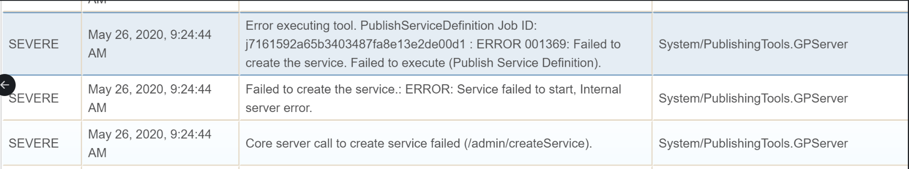

We have set of services to publish on the server. Some of the services are getting published successfully and some of the services are failing with following error Messages.
We tried publishing services using following ways:
1. Manually Publish MXD from ArcMap with(Http and Https Admin connection)
2. Manually Publish .SD File from ArcGIS Server manager page.
3. Automated service publishing using ArcPy code

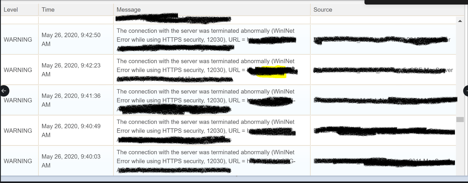

When we are tried running following link:
Error: A connection with the server could not be established (WinINet Error while using HTTPS security, 12029), URL=http…
