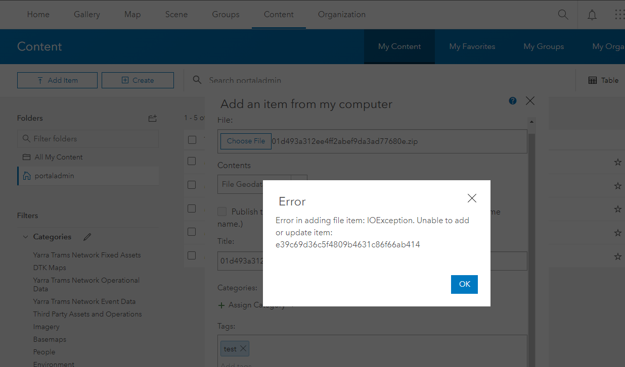

I cannot add an FGDB from 6MB upto 200MB+, it says error in adding. I suspect it has something to do with multi-part uploading, as seen in Portal logs (attached)?
Steps to reproduce:
10.8.1 Portal > My Content > Add Item > choose FGDB *.ZIP > select File Geodatabase, dont publish.
Expected results:
Added ok.
Actual results:
Error popup, "Error in adding item. IOException. Unable to add or update item: <title>.'
More info:
