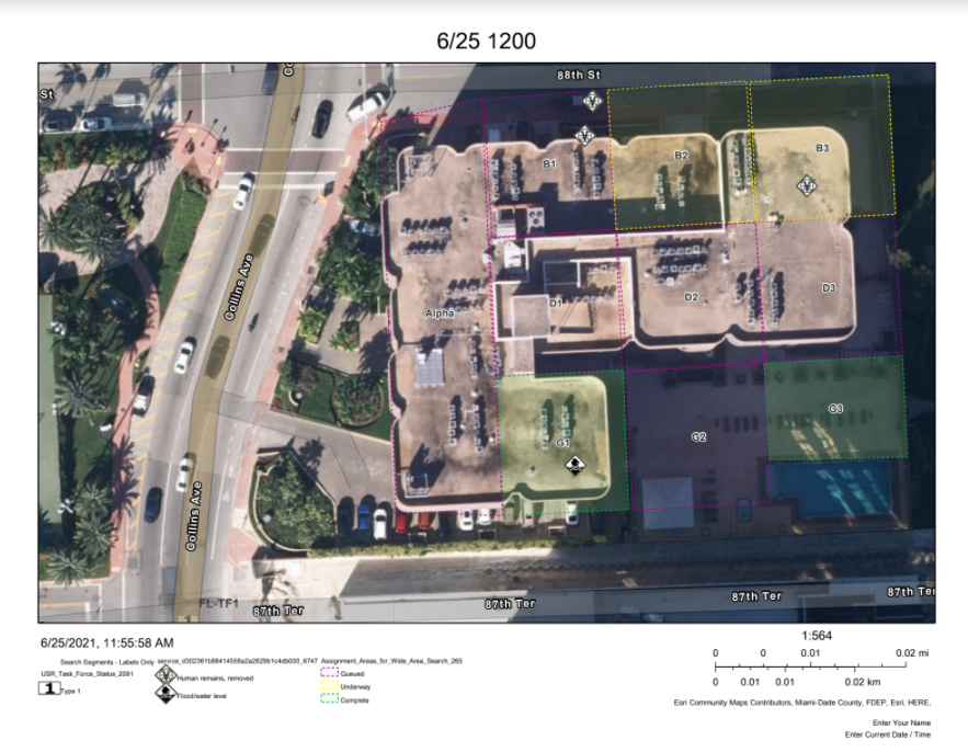

Not so good map made with Web AppBuilder (off-centered, no north arrow, wierd legend and scale bar, etc.):

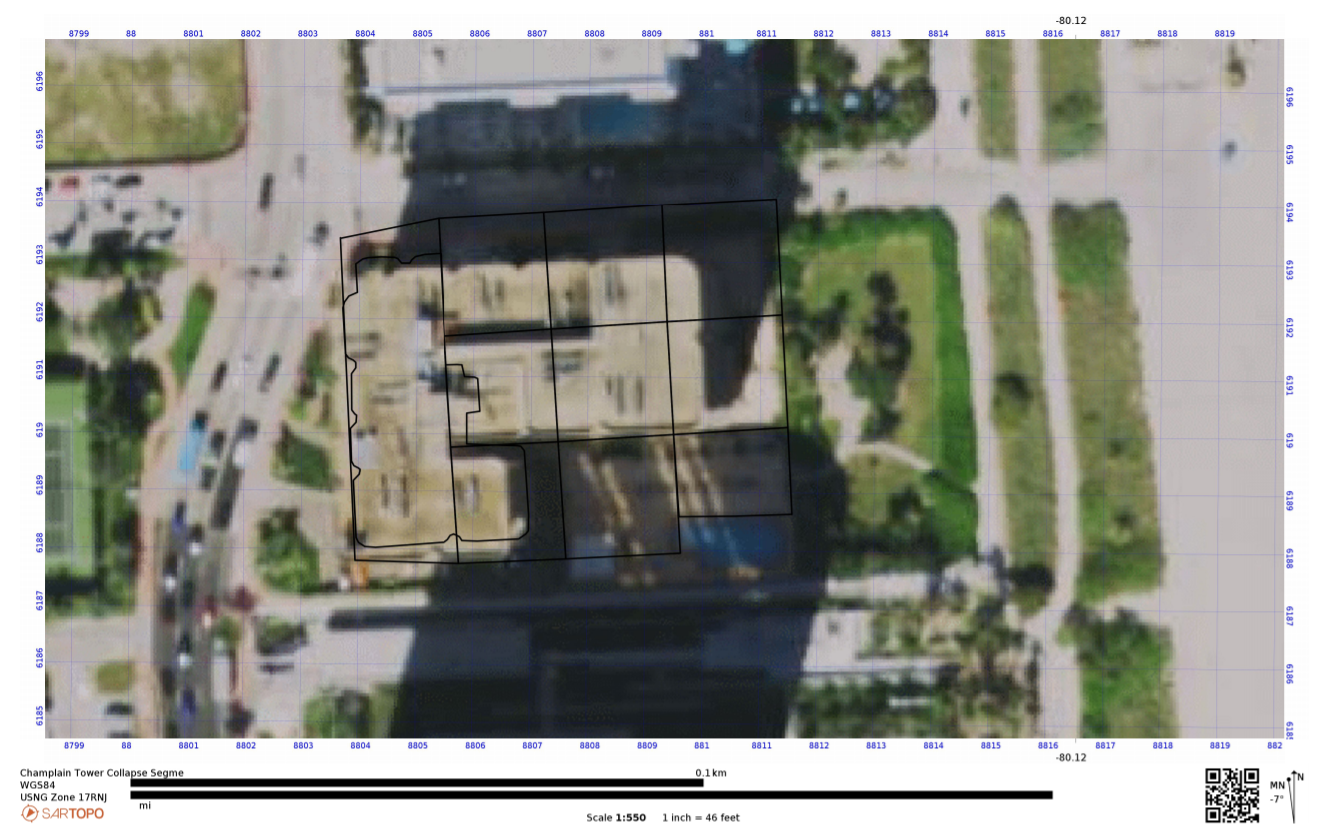

Slightly better map made with SARTopo (but not using our common operating platform or imagery)

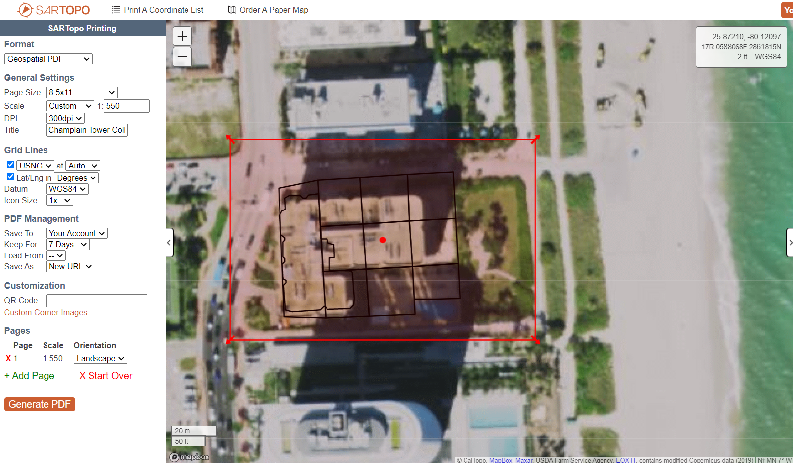

SARTopo Examples below:
Video: https://training.caltopo.com/all_users/print
Blog: https://training.caltopo.com/all_users/print

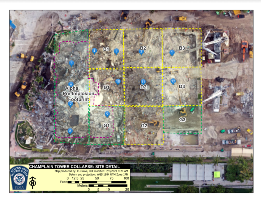

Ideal Map made with ArcGIS Pro:
