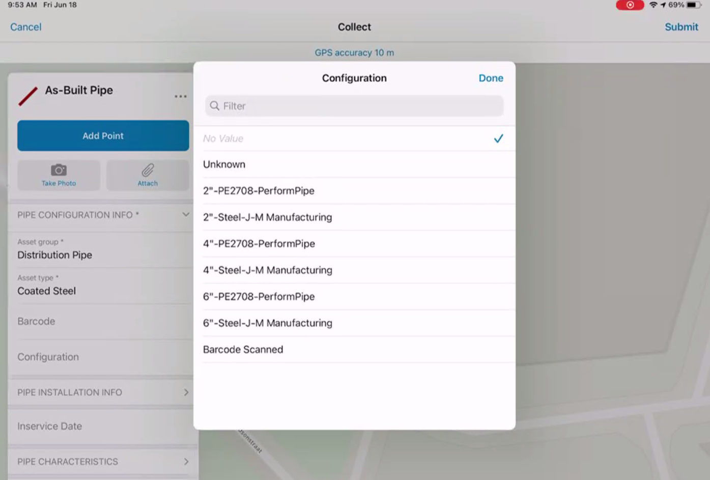

When installing steel pipe or steel components, a different approach is required. Currently there is no industry barcoding standard for steel. So, how can field users avoid manually entering every unique characteristic?
The short answer is to give the field user a list of asset configurations to choose from. This configuration list represents the valid list of sizes, models, and manufacturers the gas organization uses as part of its standards for current pipe system construction. Legacy company configurations, which are no longer used, need not apply. We only want a list of valid configurations for today’s company compliant pipes and components.
The field user selects the desired configuration from the picklist. ArcGIS Field maps will then read the characteristics of that asset from the look-up table and automatically write the information to the newly installed asset’s data fields. There is no manual entry for the field user. It is a simple matter of selecting a configuration from a picklist. The software will do the rest.
Implementing this capability not only addresses the issue of how to enable field users to quickly and accurately document the characteristics of newly installed steel pipe or a steel component, this same configuration can be used for situations where the plastic barcode is unreadable due to being smeared, scratched, or otherwise obscured.

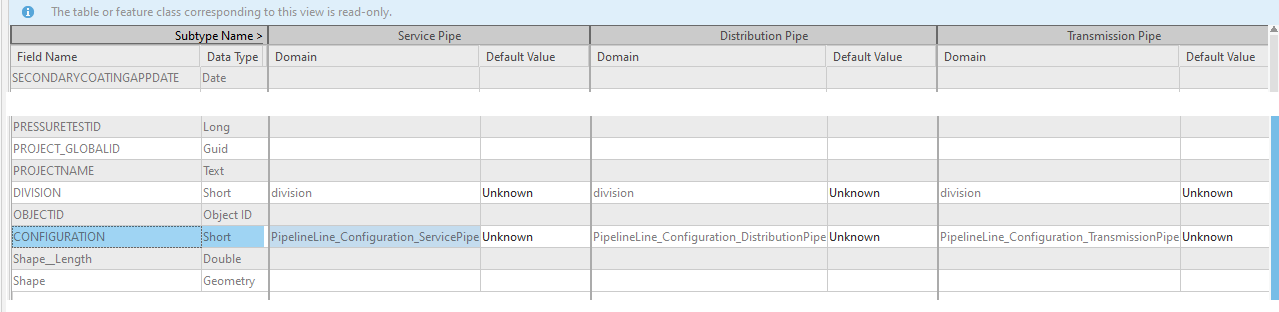

The picklist is defined with subtype specific coded value domains. This simplifies the field user experience by shortening the list of configurations to those which apply to a specific type of asset. Service Pipe, Distribution Pipe, Couplings, Elbows, and Controllable Valves are each separate coded value domains.
The domain is defined as a field type of short integer. The short integer value is the primary key to the configuration lookup table. The coded domain description is the text which you want the field user to see in the picklist.

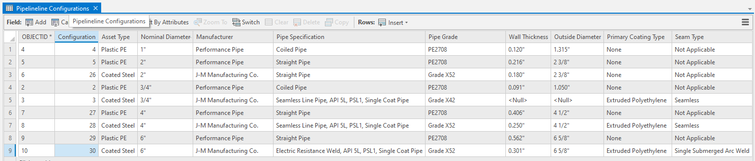

With the subtype specific coded value domain now defined, there needs to be a source which contains the characteristics (pipe diameter, material, manufacturer, wall thickness, etc) for each configuration.
This lookup table is a standard geodatabase table. It must reside in the same enterprise geodatabase as the staging layers which will store the field captured assets.
To simplify the integration with the staging featureclasses and the final production featureclasses, the schema of this table should match the data fields into which this information will be inserted.

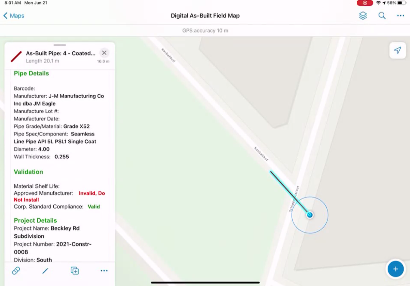

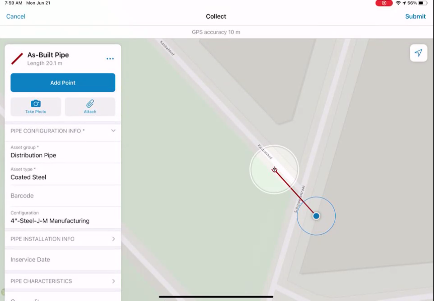

When these three configurations are added to ArcGIS Field Maps, the field user experience is simplified. The user selects the configuration from the picklist, such as 4” Steel by J-M Manufacturing.
The software runs the script, which retrieves the configuration information from the look-up table, and inserts it into the new record.
The pipe record now has its characteristics automatically populated. No barcode, no problem.
