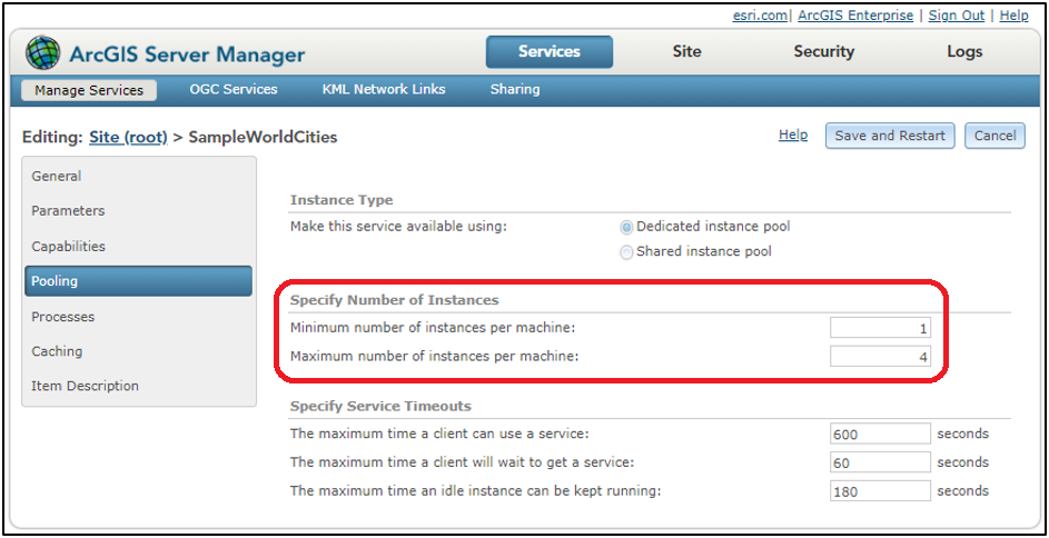

- When testing a traditional (e.g. dedicated) ArcGIS Service, ensure the minimum and maximum instances are set appropriately
- This is necessary if your test goal is trying to understand the maximum achievable throughput from the service
- For max throughput, a general rule of thumb is to set the maximum instances to the number of CPU cores
- For predictable performance, set the minimum instances to the number of maximum instances
- Adjusting instances will cause a service to restart (plan accordingly)
- Increasing minimum instances of a service will require additional physical memory from the ArcGIS Server machine

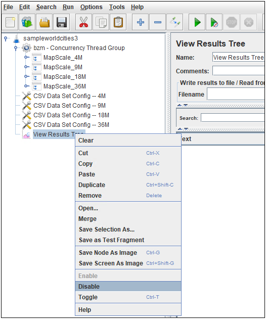

- If the Test Plan contains a Listener like the View Results Tree, ensure to disable it from the GUI
- Running Listeners can increase the consumption of test client resources and potentially impact the test

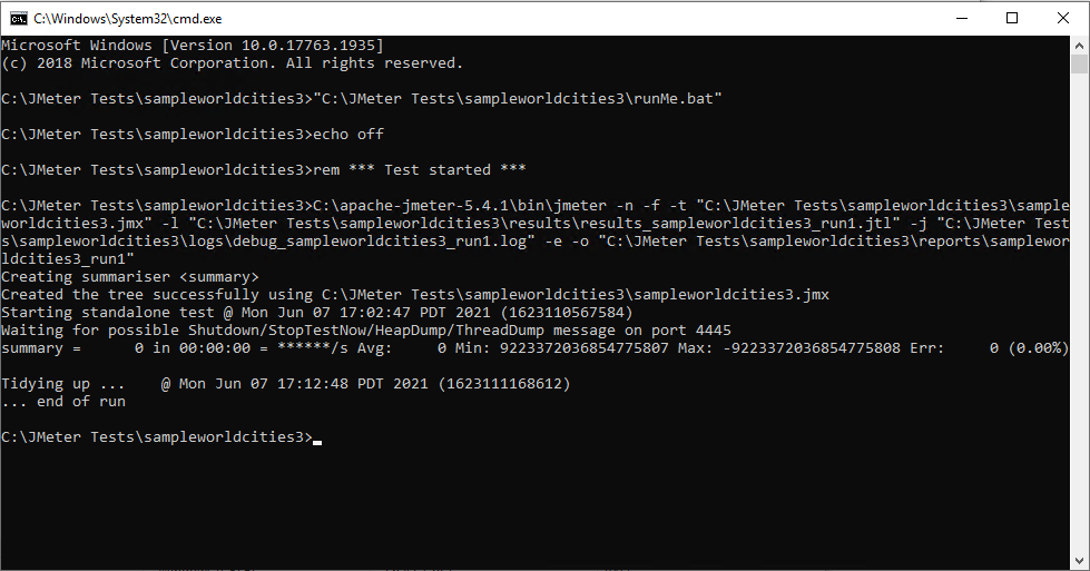

For the first first runs of your test, it is recommend to execute it from command window that is already open. This way, if there are immediate issues invoking any the commands in the batch script, they will persist on the screen so they can be corrected more easily (e.g. a typo).
- From Windows, you can invoke a Command Prompt window by clicking Start, then typing cmd.
- Once this window appears, enter in the path to your batch script:
- "C:\JMeter Tests\sampleworldcities3\runMe.bat", hit Enter
- The script will run for the configured duration then return to the command prompt
Running from command-line mode does not provide the console with real-time statistics of the test execution. Such functionality can be obtained but is not covered in this Article.

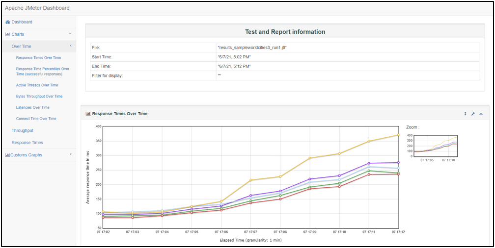

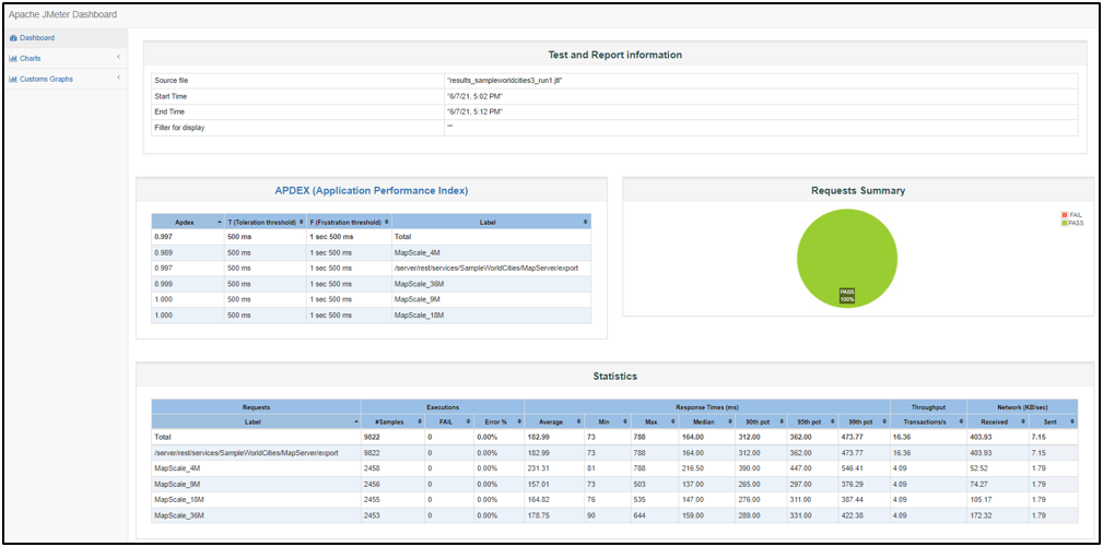

Test artifacts are items created from the load test that can be used for analysis. Items like report and the JMeter Text Logs (JTL) files which contain the raw test results are typically the most important to retain. The run log can also be useful as its listing can be used to confirm the configured memory of the environment for the test run as well as updates to which step was being executed and when. After multiple runs of the same test, where a different runname in the script was used, it is easy to wind up with many jtl files and report folders. This is where following the testing strategy of utilizing a project folder for management is key.
Note: The report generated by JMeter is HTML and JavaScript based. If some components of the report are blank or do not appear to render, try adjusting the security settings of the browser or open in another browser, if available.
- The initial page and Response Times Over Time section of a JMeter generated report
