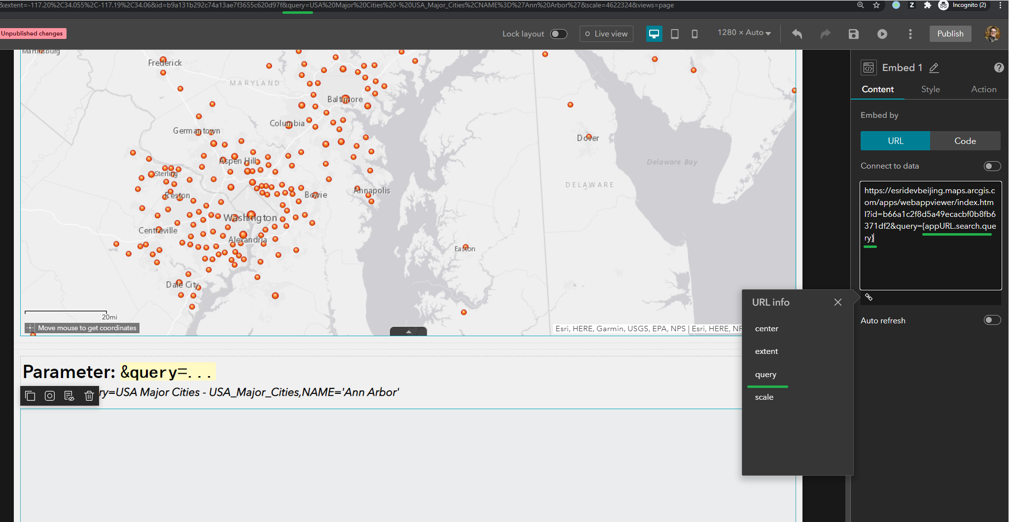

- After all the above information is ready, create an ExB app, drag an Embed widget to the canvas, save the app;
- Now, add the desired URL parameters that your embedded content is going to use to the ExB builder URL, in the browser tab, then click Enter to refresh the builder page to take effect, like this:

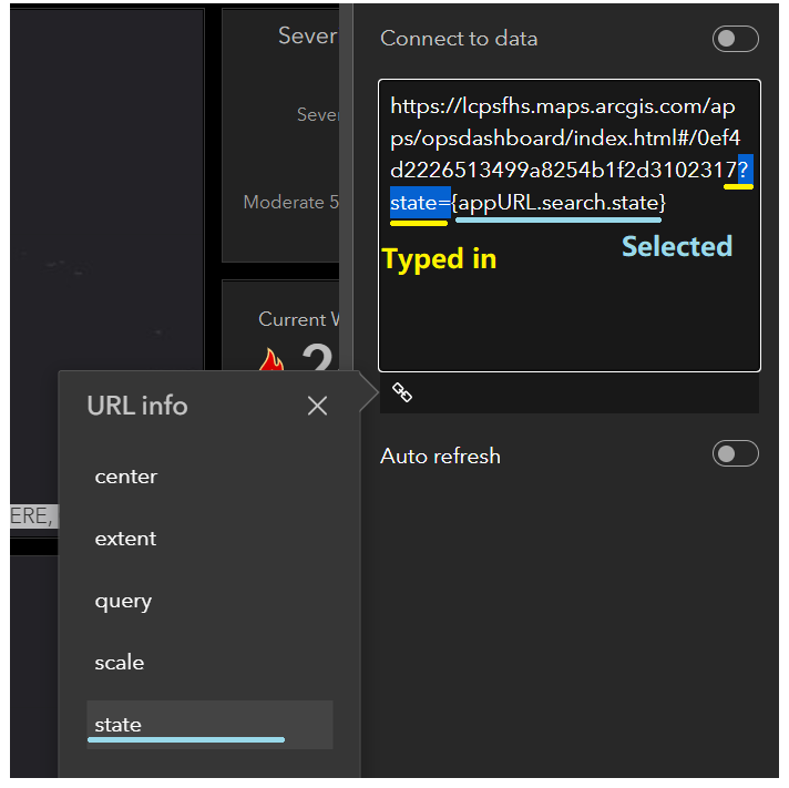

Note: there should only be one '?' in the URL parameters. The following ones should be changed to '&'. - Inside your Embed widget, type your URL and the &query= part, for example, and then you will be able to open the URL info panel and add the app URL info as the value of this parameter at runtime. Note that the URL info generated by user selection will be in the format of {appURL.search.xyz}.
After all the content being configured, save the app, and run preview mode. Note that preview will not inherit your builder URL parameter for now so you would need to add them on later.

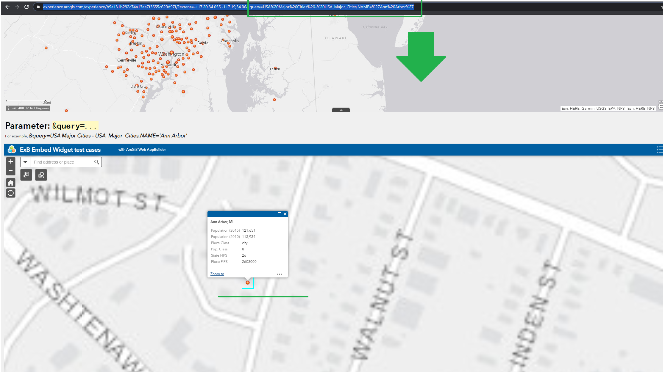

In the previewed app, all URLs will be removed now, so the added URL parameters for the embedded content shall be not affected, instead, it will show the content as it is without any URL parameters.
- Now, add any of the corresponding URL parameters added previously, and refresh the page, you can see the one that used the corresponding URL parameters will take effect and pass it to the embedded app

1. Embed Case1_How to use the app URL1_WAB
End-user cases:
https://experience.arcgis.com/experience/b9a131b292c74a13ae7f3655c620d97f/?query=USA%20Major%20Cities%20-%20USA_Major_Cities,NAME=%27Ann%20Arbor%27
https://experience.arcgis.com/experience/b9a131b292c74a13ae7f3655c620d97f/?query=USA%20Major%20Cities%20-%20USA_Major_Cities,NAME=%27Redlands%27
...(can change per user's request and then show the different cities here)
2. Embed Case1_How to use the app URL2_embedDashboard
End-user cases:
https://experience.arcgis.com/experience/9b69e6e7a6984952944d0410ac9b1872/?state=Michigan
https://experience.arcgis.com/experience/9b69e6e7a6984952944d0410ac9b1872/?state=California
