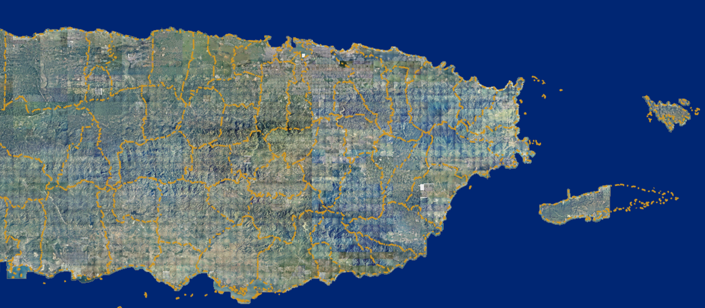

I had some problems with a HA Enterprise implementation 10.7.1. First one portal had problem, i solved it, then ArcGIS Servers started to have problems, if i restart arcgis service from server 1, server 2 stops working and if i restart service from server 2, 1 stops, but I was able to solve it, then I had problems with services and my Enterprise geodatabase was not responding so i restart SQL Server service and everything was working but then I notice that 2 items were missing. one it my 1998 photo map service.

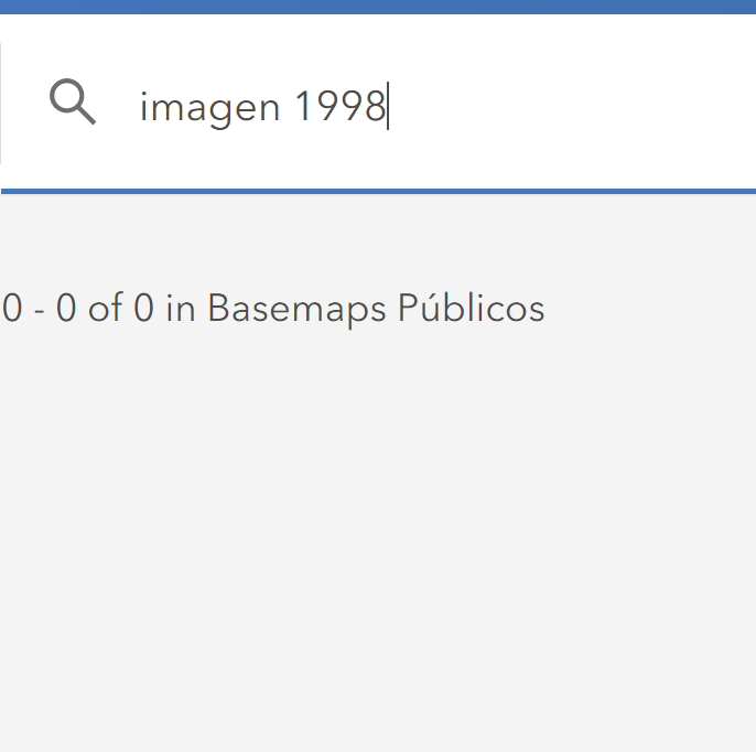

If I search for it is not there

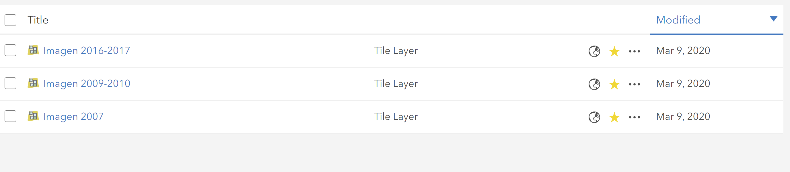

When I looked at the folder it used to be is not there also.

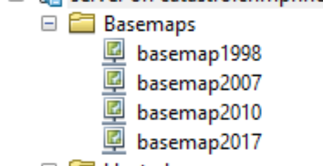

But if I look at the server services, is there

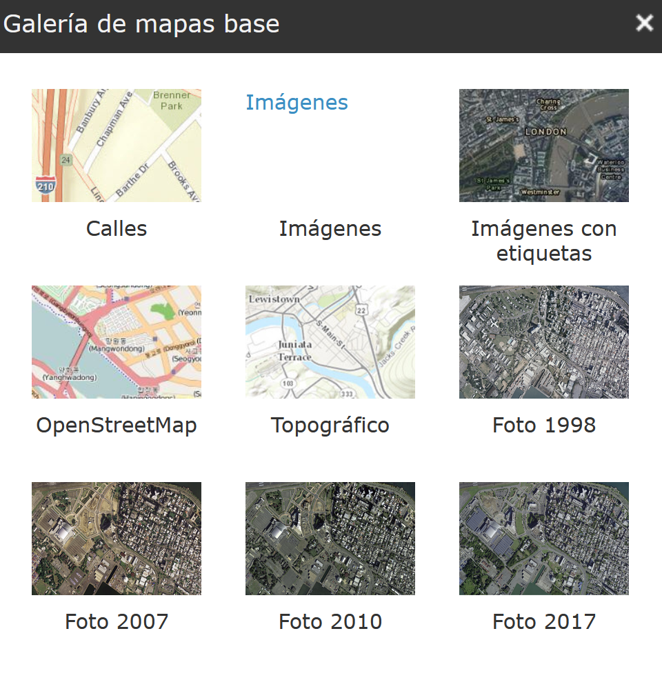

And in my app that is used i can see it there.
And i can use it.
