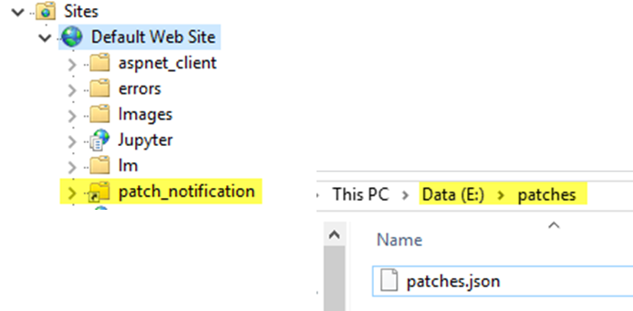

- Download the patches.json file from here - https://downloads.esri.com/patch_notification/patches.json
- Host the patches.json file on a web server with the same context as above (For IIS, make the following directory “C:\inetpub\wwwroot\patch_notification” (Or a virtual directory of the same name) and put the patches.json file in that folder
- Set up network routing (DNS or Host File change) so that when the Patch Notification calls the above URL, it finds your locally hosted version
