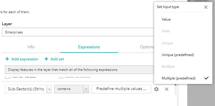

The second difference is that you cannot set a ‘predefined’ input type (or any input type) for the filter value in Experience Builder, which is an option that is available in Web App Builder:
My use case for this is essentially working with spreadsheets where a field contains a list of values. The ‘predefined’ values option allows list items to be separated, and also allows a label to be set to reference each value.
