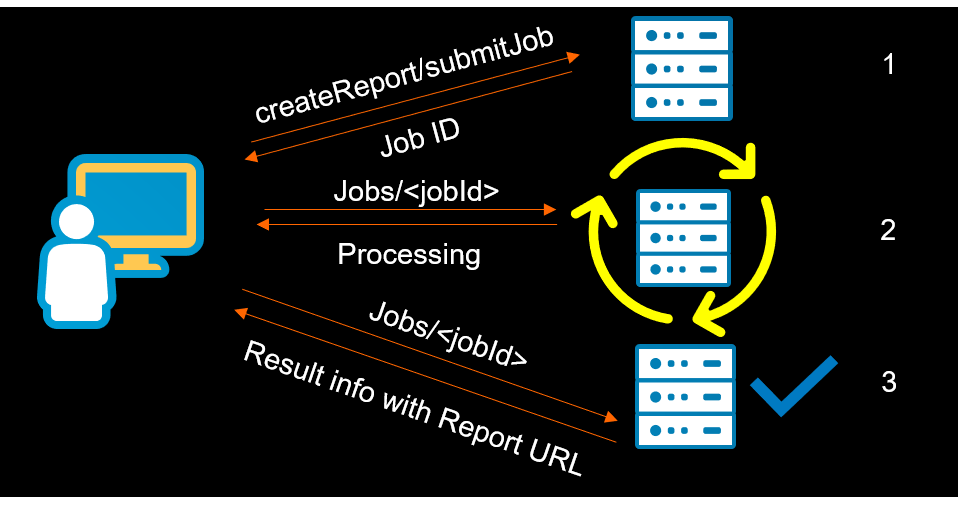

The general workflow when using the Survey123 REST API is to start off by sending a submitJob request to the API. This request will contain information such as the REST URL for the feature layer associated with the survey, query parameters, item ID for the template item you would like to use, and a valid access token. The response of the submitJob request will provide the ID for that specific job. Using that job ID your application will need to send periodic requests to the jobs resource passing along the ID supplied from the submit job task. When the task finishes, and the report is ready the response of the jobs request will contain the result information on the report as well as the URL to download the report.
