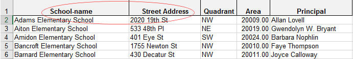

Column Names
ArcGIS Pro converts the first row of Excel worksheet data to field names, so the first row in your Excel worksheet should contain column names. If the first row contains other content, modify the worksheet so that the first row contains column names.
- Depending on your organization’s data requirements, you may want to make a copy of the worksheet and modify the copy.
Column names must be 64 characters or less.
ArcGIS Pro field names can contain only letters, numbers, and underscores (no special characters). Best practice is for Excel column names to begin with a letter, especially if you want to join the Excel table to another table.
- Note: Column names that begin with a number will have an underscore appended in front of the number in ArcGIS Pro. Spaces and hyphens in Excel column names display as underscores in ArcGIS Pro.

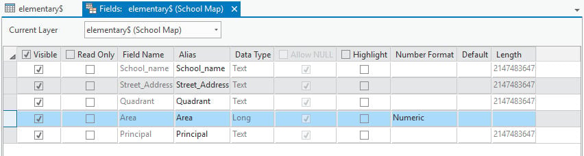

ArcGIS Pro assigns the data type for a column containing only numbers to be numeric. This makes sense, but suppose you have a column of ZIP Codes?
Items such as ZIP Codes, U.S. FIPS codes, NAICS, and SIC codes should be treated as text, since mathematical operations don’t apply to this data. In the table below, the Area field has been assigned the long integer data type. In fact, this field contains ZIP Codes.
If the data type assigned to a field is not desirable for your data, you can join the Excel table to another (editable) table in ArcGIS Pro, then add a new field of the desired data type to the joined table and calculate its values to be the data from the source Excel column.

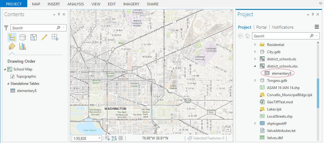

How to Access an Excel worksheet in ArcGIS Pro
- Start ArcGIS Pro, open a project, and insert a map if necessary.
- In the Catalog pane, navigate to the folder containing the Excel file.
- Click the plus sign next to the Excel filename to expand it and display one or more worksheets. A dollar sign symbol ($) displays at the end of worksheet names.
- Drag the worksheet into the map area.

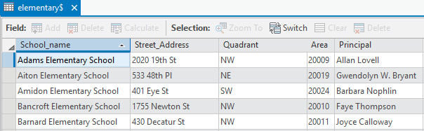

The worksheet displays in the Contents pane as a standalone table (this means it’s a nonspatial table that contains only tabular data).
To open the Excel table, in the Contents pane, right-click the table and click Open.
You can sort fields, turn fields off and on, assign field aliases, and export the data to a geodatabase table or CSV, DBF, or TXT file.
