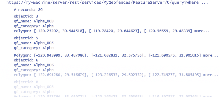

To begin testing the scenario described above I published a feature service and added a few dozen polygon feature records to the service's feature data set. I can query the feature records via the feature service's REST endpoint:
Notice that each feature record has two attribute fields, gf_category and gf_name, which can be used to uniquely name and organize geofences when they are imported into GeoEvent Server.

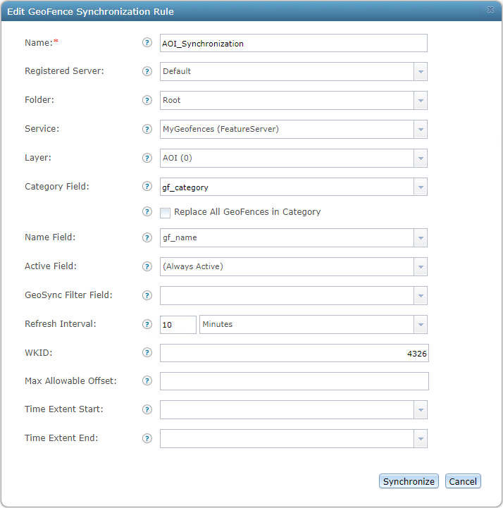

Next, in GeoEvent Manager, I configure a synchronization rule that will query the feature service every 10 minutes. The feature records illustrated above will be loaded into the GeoEvent Server’s AOI Manager which handles the addition and update of geofences.

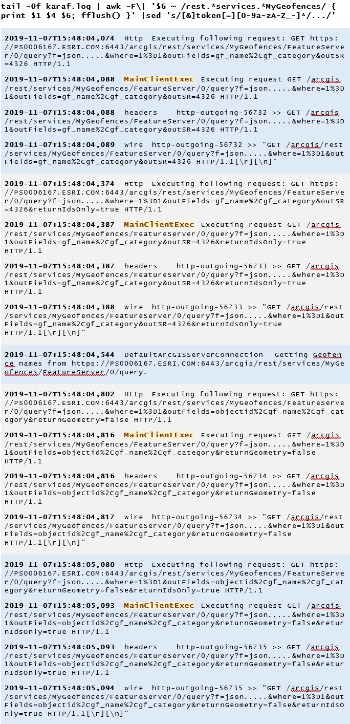

Determining which component logger(s) to watch
The following illustration shows the output produced when the command above is used to filter the large volume of messages logged by all components when debug logging is requested at the ROOT level. For this example, assume that the command was run just before the Synchronize button is clicked to force a geofence synchronization rule to perform a set of queries against the feature service.

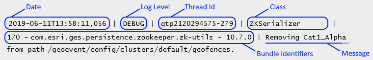

One pattern that stands out immediately is that there appear to be four requests made. Different component loggers represent these the requests in their own way, but we see key phrases repeated such as "Executing following request", "Main Client Exec ...Executing request" and the request's outgoing headers and actual request going out over the HTTP wire:
(Click to Enlarge Image)

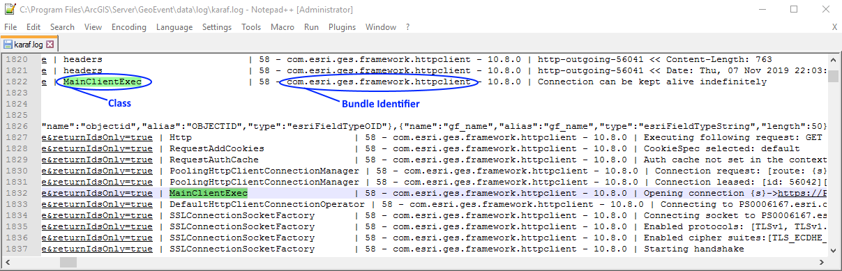

We certainly don't need to see each request represented four different ways, and a quick search of the karaf.log for the key word "MainClientExec" shows the raw (unprocessed) log messages are associated with a particular class and bundle. These are clues to loggers we can interrogate further:
If we are careful to leave DEBUG logging turned on at the ROOT level for only as long as it takes to navigate to the GeoFence Synchronization Rules and click Synchronize, then return to the Logs and change the settings back to WARN for the ROOT level, we can use the cached logged messages to generate a list of possible component loggers we might be interested in looking at more closely.

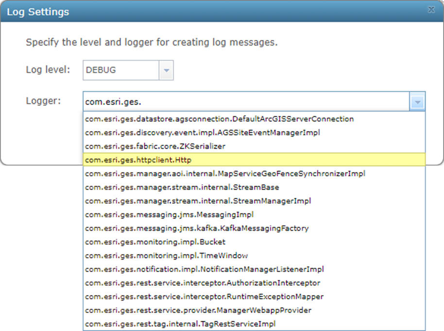

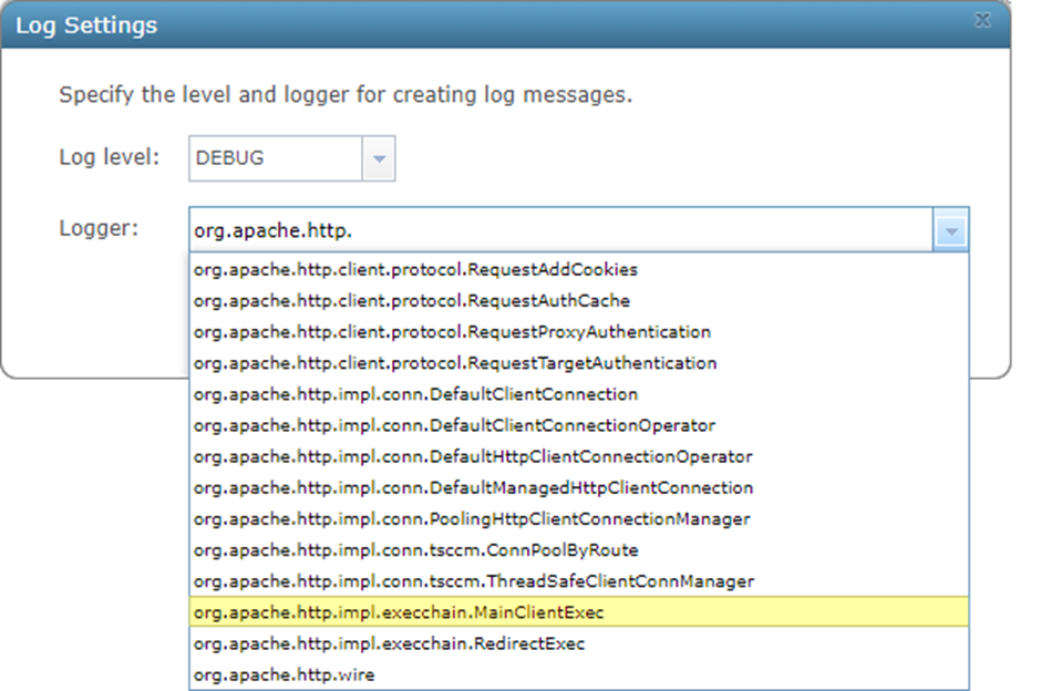

Two loggers that seem specifically appropriate are org.apache.http.impl.execchain.MainClientExec (because "MainClientExec" was identified as a class name of interest) and com.esri.ges.httpclient.Http (because the bundle identifier "com.esri.ges.framework.httpclient" was part of each logged message).
Requesting DEBUG logging on the HTTP Client logger will still produce a large number of logged messages. By targeting a single logger, however, we reduce the number of messages being logged overall; we are not interested in examining debug messages from the header or wire components for example. Also, we can tailor our sed and awk command to help further identify messages of particular interest. If we run our text extraction and format command on an active tail of the karaf.log – and take care to start and end the tail around the time that we navigate to GeoFence Synchronization Rules and click Synchronize – the number of logged messages is surprisingly manageable.
