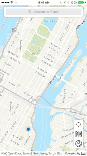

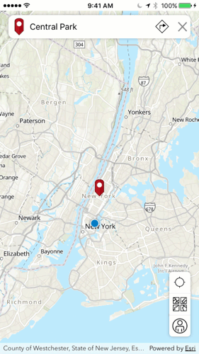

To search, simply start typing into the Search Bar at the top of the screen.
As you type, you’ll see suggestions appear, and you can either pick a suggestion or search for the text you’ve typed.
By default, you can search for places or addresses using the ArcGIS World Geocoder, and the suggestions will prioritize matches close to the center of the map.

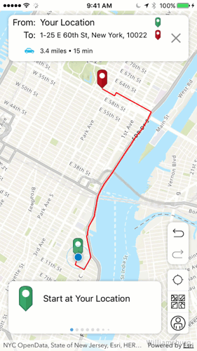

Whether you’ve searched or reverse-geocoded, the results panel includes a “Directions” button. Tap this to calculate directions from your current location to the search result.
At the top of the screen you’ll see an overview of the entire route, and at the bottom you can see turn-by-turn directions. Just swipe through them and the map will update to display the current step. If you ever want to go back to the entire route, simply tap the route summary at the top of the screen.
