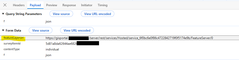

Here's the request that's sent when you try and create a sample template on survey123.arcgis.com.
The payload of the request seems to be OK, the featureLayerUrl is correct and accessible in a browser
