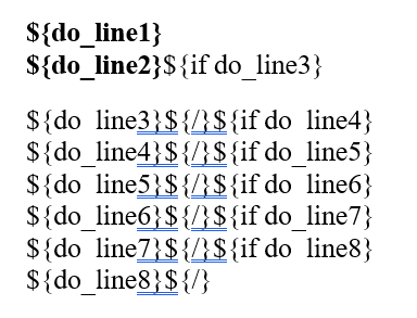

I'm using Survey123 and have created two report templates. I have a single record report template and a summary report template. I'm running into an issue where my summary report template will not keep a line space between ${do_line2} and whatever line value exists next in lines 3 through line 8. When I run the same template without the summary and repeat in my single record template, it behaves as expected. There will always be a line space between ${do_line2} and whatever line value exists next. Below is my template for the single record report:

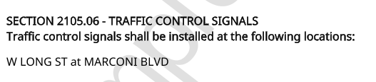

And below is the output I get, regardless of what line value exist directly after do_line2:

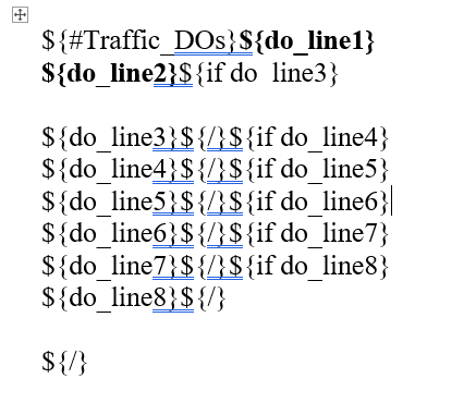

This is the report template for my summary records report:

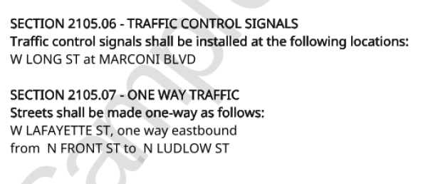

And this is the output I get:
