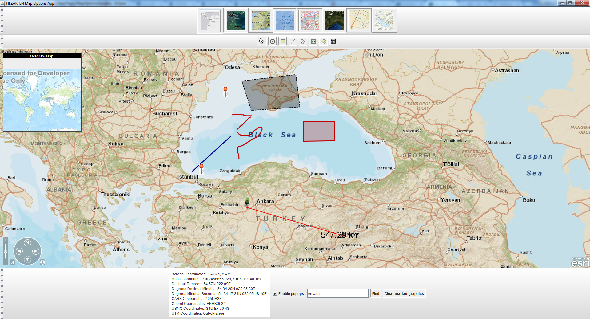

I developed a simple GIS module through using the ArcGIS SDK on Java with these features :
- Map : Map options, Map coordinates
- Toolkit : Navigator, Overviewmap, Drawing overlay
- Graphics layers : Select graphics, Draw graphics
- Geometry : Line length
- Routing and navigation : GPS layer, Advanced GPS info
Everything is working well in online mode. But at production stage there will be no internet connection at client side.
So, how can i refer to a SATELLITE or NATIONAL_GEOGRAPHIC or STREETS etc. version of a map on local machine while serving the features listed above also?
