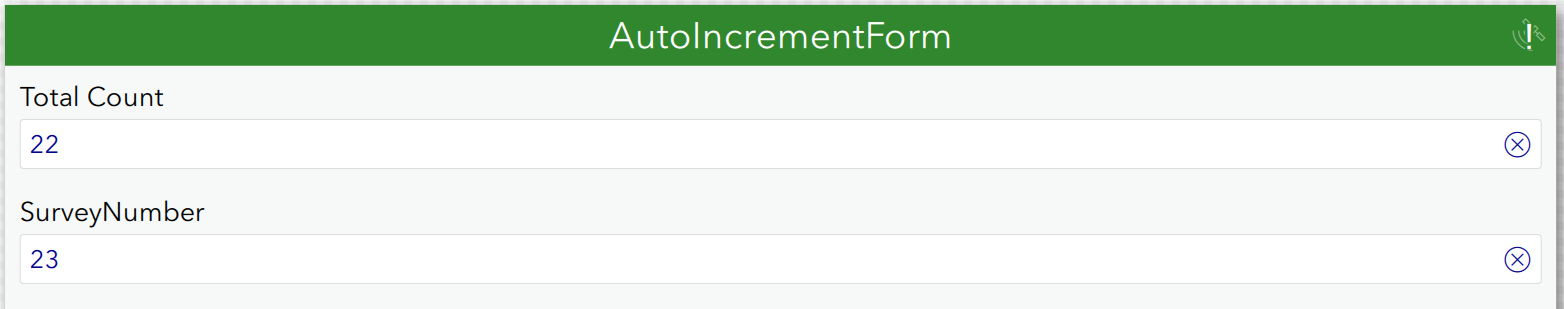

Sounds good so far. With this though, you’re just going to get the number of surveys submitted up to this point. For the prepopulated answer, you need to add one. Just create a new row in the .xls form, and put ${*Name of your total count field*}+1.
The layout for this workflow in an .xls form
How it looks in the form - the feature class has 22 records, and the second question is the "+1"
It’s probably best to hide the first field and set the second one to read only (which will get rid of the blue Xes). Your use case may vary, but usually the simplest option here is going to be best.

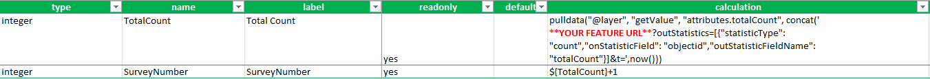

The fix is straightforward: append the query to make it non-duplicative. That way, pulldata() cannot rely on using the most recent pull, and won’t be able to rely on now outdated values. Rather, if we append the string to add a timestamp, it will have to go and look up the time, every time.
The extra parameter listed in the bug documentation is ("layerUrl?t=", now()). This makes sense – now() requires the string to collect the time… right now! We’re going to force the pull to check the time whenever a new survey is brought up, and whilst its there, check the latest ObjectID counts too. Appending it to the string we have so far looks like this:
pulldata("@layer", "getValue", "attributes.totalCount", concat('**INSERT FEATURE URL HERE**?outStatistics=[{"statisticType": "count","onStatisticField": "objectid","outStatisticFieldName": "totalCount"}]&t=',now()))
The cachebusting query in an .xls form
We now have a non-duplicative query. Including the timestamp prevents the caching mechanism from serving the same results for the formerly identical query. This tiny crumb of variability, which makes each pulldata(@layer) unique, is perfect for ensuring that our query fetches fresh, non-duplicative information from the dataset.
