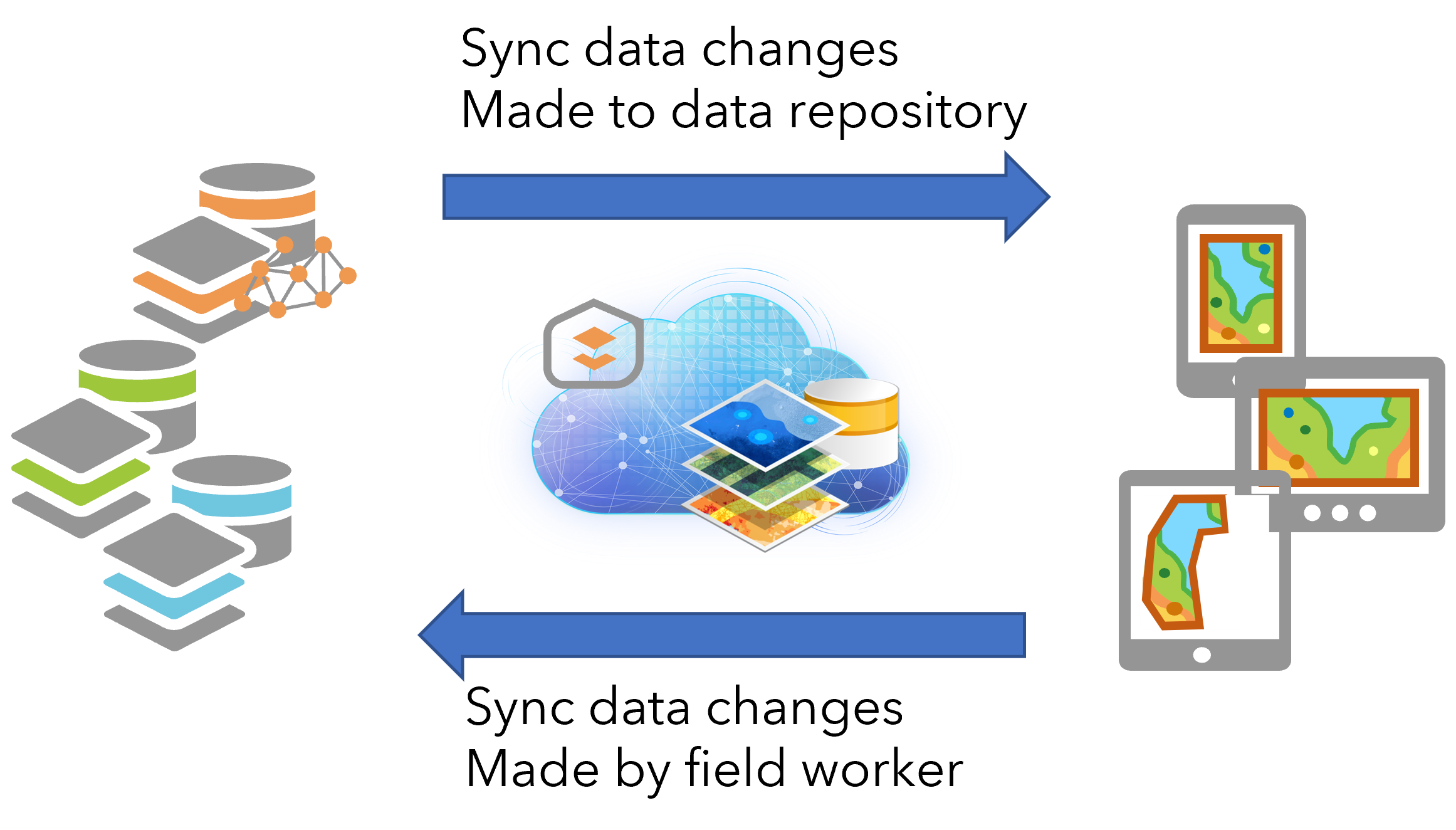

Offline map areas provide the ability to maintain a copy of your mapping data on your mobile device (phone, tablet, laptop). This capability of ArcGIS allows Esri-based mobile applications such as ArcGIS Field Maps to access this locally stored data and present it to the utility field worker even when all communication networks are down.
This capability of ArcGIS can be extended to foreign crews and the devices they bring with them. A simple email can not only thank them for assisting with the event, but also provide instructions to download the application, log into the local utility’ ArcGIS Portal, and download the required offline map area(s) for the region they have been assigned to assist. All of this can be completed in a few minutes before they enter the disaster zone.

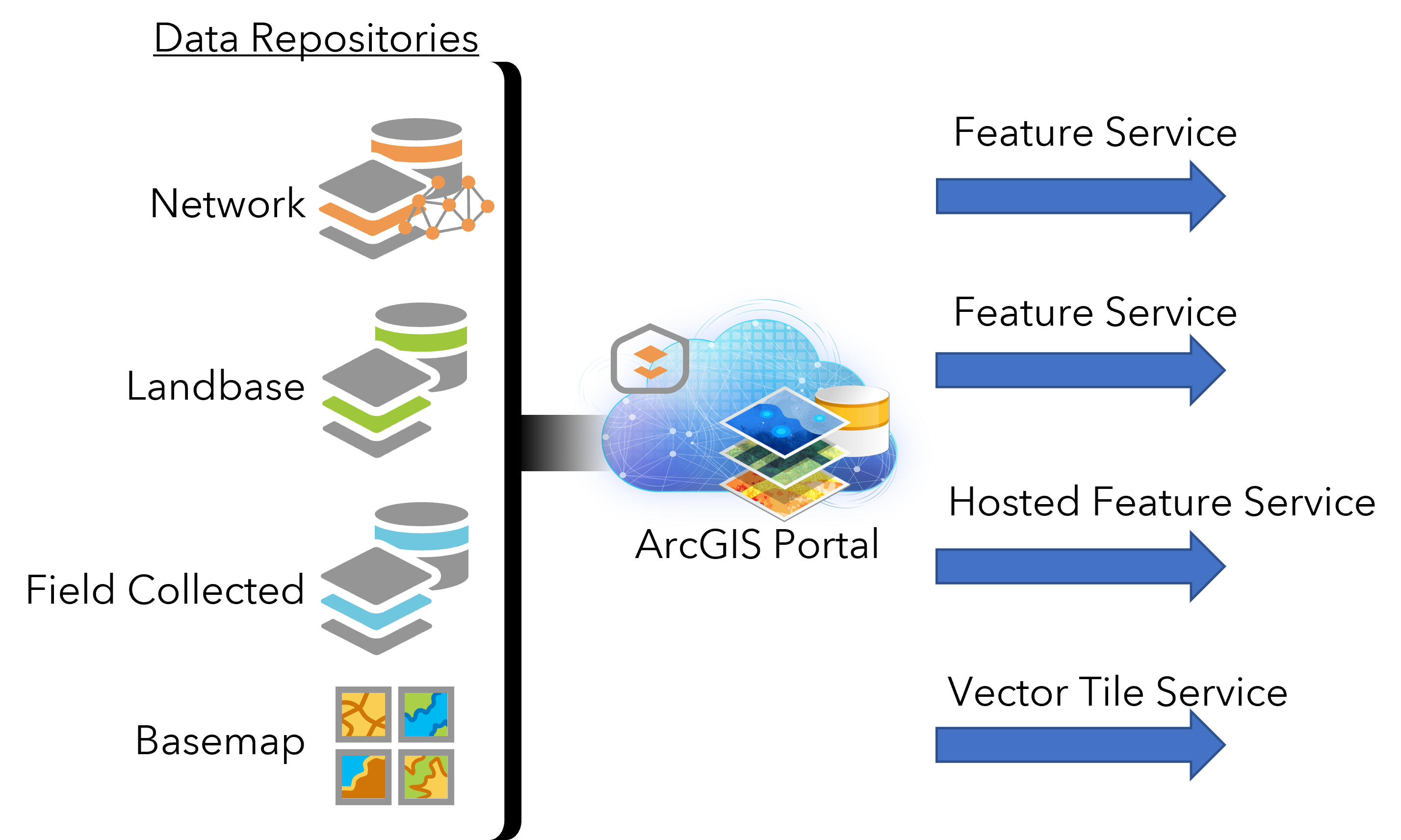

Data to Take Offline
The data to be taken offline can be grouped into four categories: Network, Landbase, Field Collected Data, and Basemap. Each of these categories is comprised of many data layers and tables.
Network: This is the utility’ inventory of pipes, conductors, cables and all connecting assets and structural assets which comprise the network. For ArcGIS implementations at a utility this will increasingly be organized with the Utility Network Management capabilities.
Landbase: This is the utility-maintained set of referential data such as utility boundaries, governmental boundaries, property boundaries, and street curb edges.
Field Collected Data: This is the set of layers that utility field workers will add to and update with the information they collect. Examples of this type of data are damage assessments, meter outage status, and inspections.
Basemap: This data layer provides the transportation network (streets, rail, and pedestrian) as well as parks, buildings, and in some locations even sidewalks and trees.

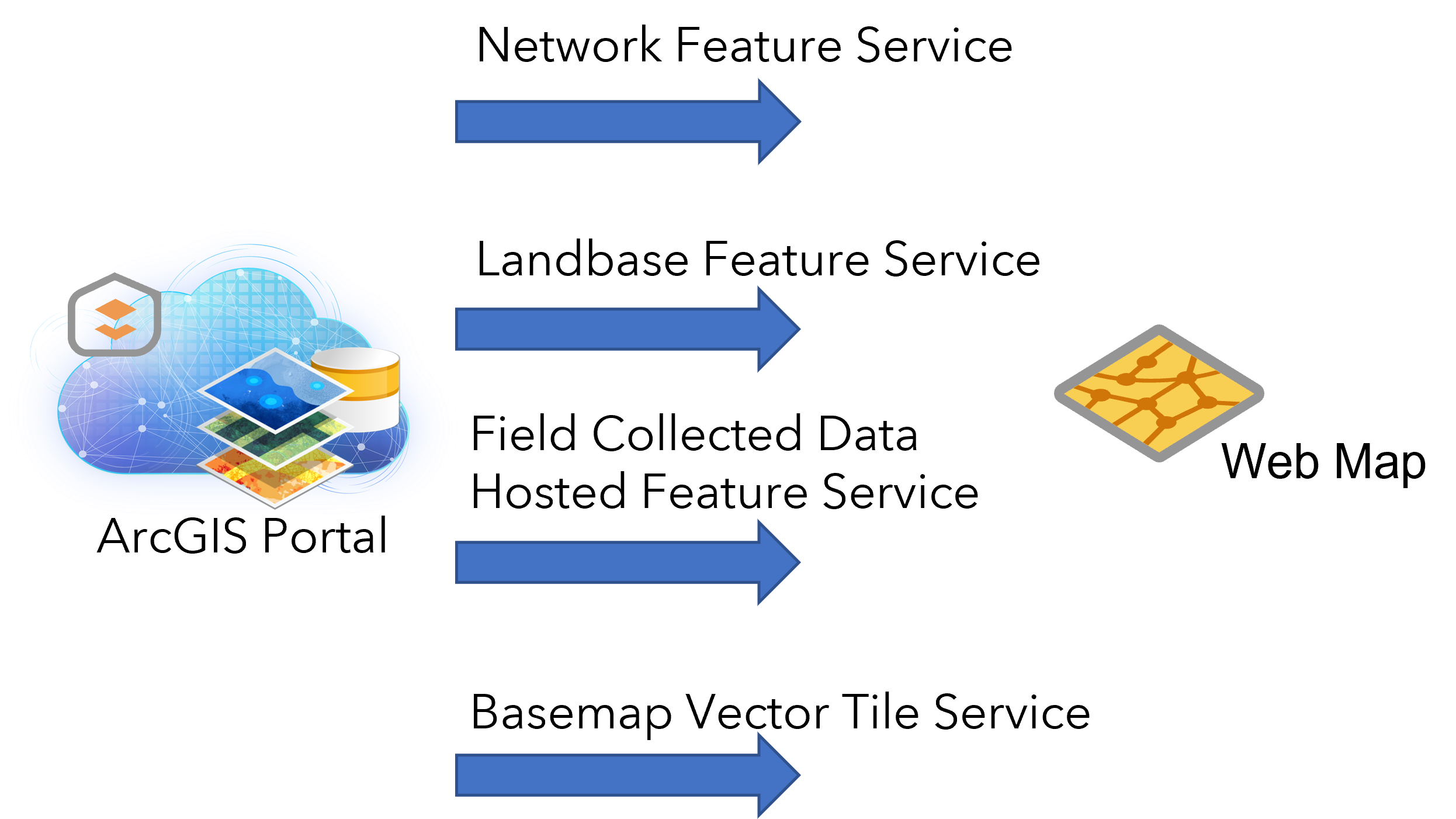

To get these datasets into the hands of the utility field worker requires four primary steps. These steps are preparing the data, publishing the data, creating offline map areas, and deploying it to the mobile device.

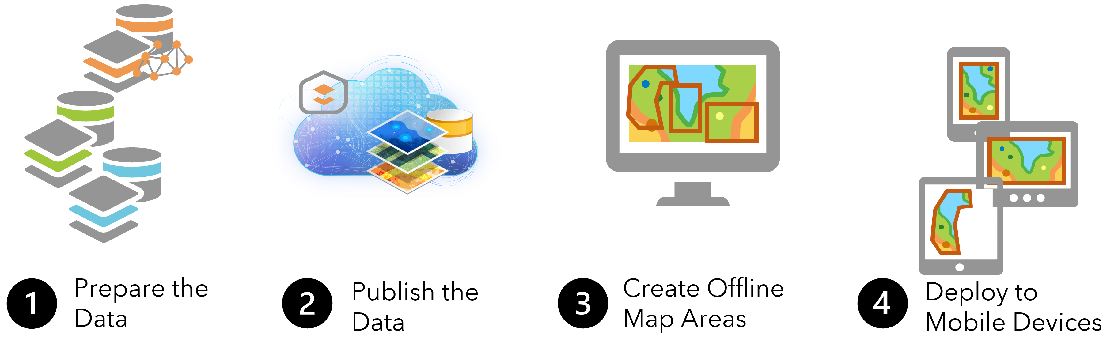

Publishing the Data

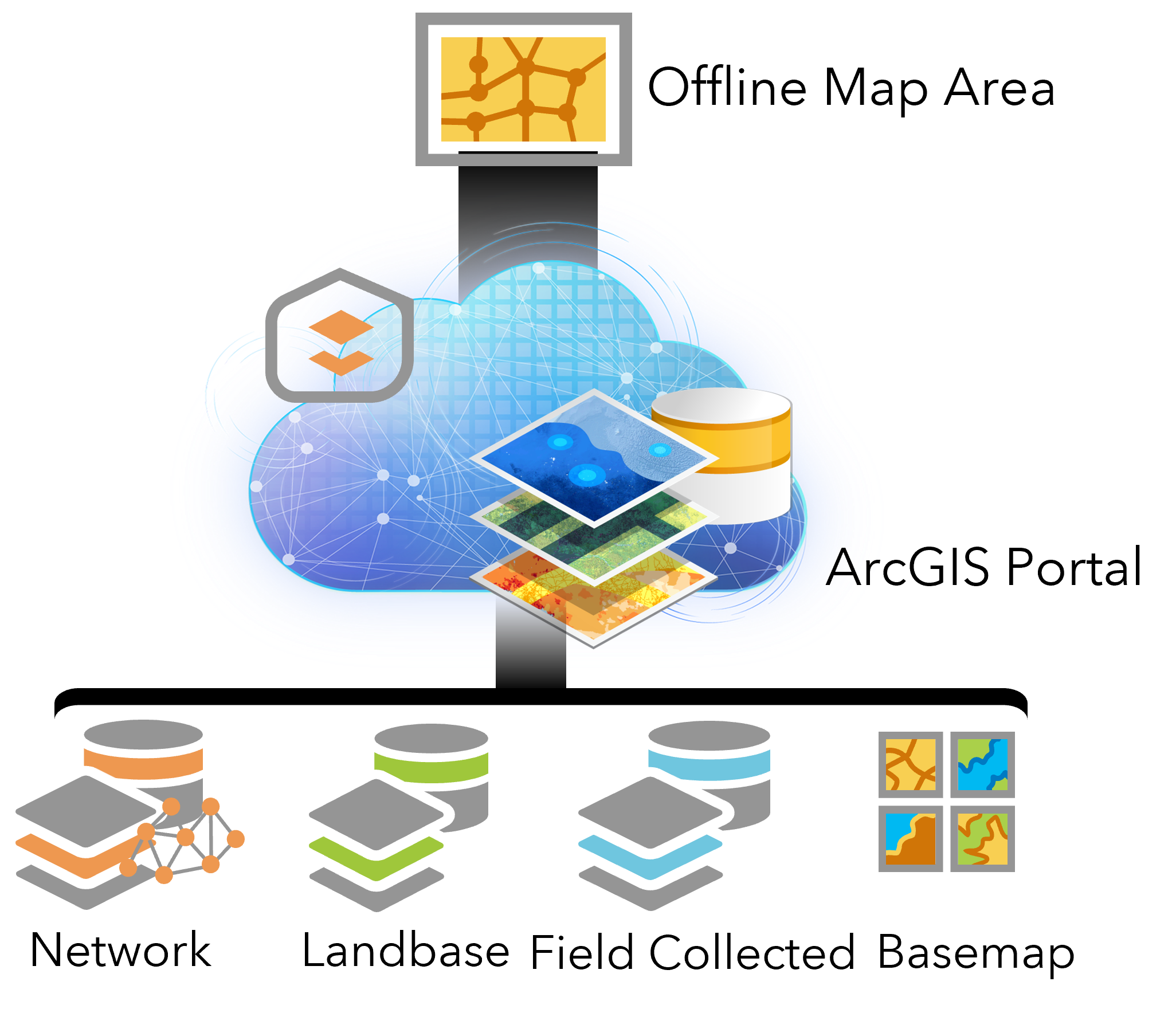

To get the data from the office data repositories to the hundreds or thousands of mobile devices used by a utility’s field workers requires the communication capabilities of web services. There are multiple types of web services available with ArcGIS. Not all web service types available in ArcGIS support the exporting of data to an offline map area. The four types of ArcGIS web services which do support exporting data to an offline map area are feature service, hosted feature service, vector tile service, and image tile service. Of these four types, only the feature service and hosted feature service support delta synchronization data exchange with the offline map areas. The other two service types, vector tile service and image tile service, only support exporting data to the offline map area. They do not support synchronization.
When publishing multiple data repositories, each repository must be published as a separate service. For our four categories of data, each will be published as a separate service.

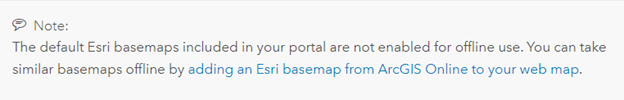

The publishing of the basemap is a special situation. These Esri-curated layers provide beautiful cartography and impressive spatial accuracy. But only a special subset of basemaps allow inclusion in offline map areas. These are a special subset of the basemaps published by ArcGIS Online.
Of that subset, only the vector tile services meet the geographic extent and scale resolution needs of utilities. A listing of Esri provided vector basemaps which support usage with offline map areas is available with this link.

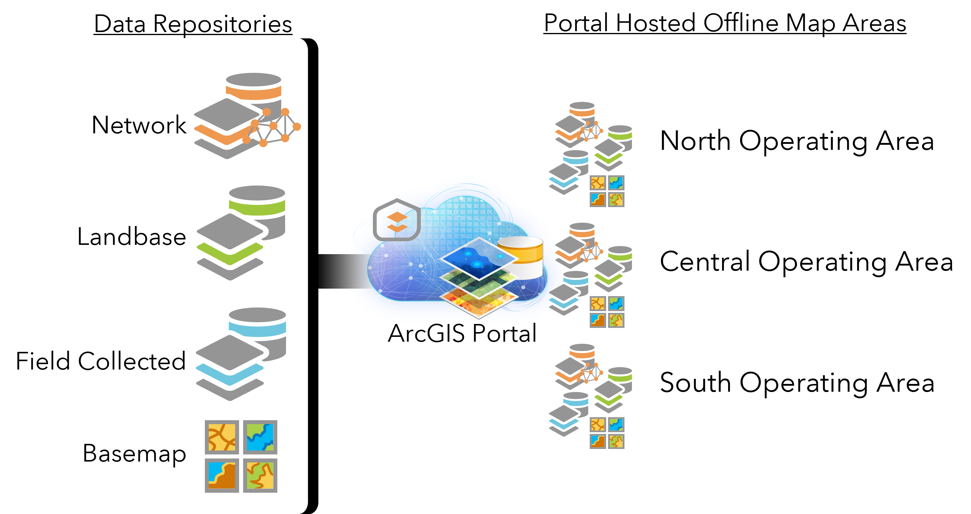

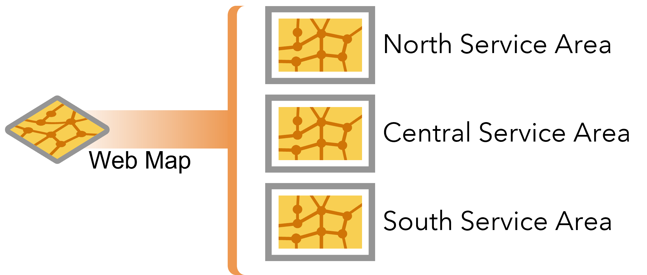

Creating Offline Map Areas
With the data now published it is time to create a web map which defines how the data is to be presented to the utility field worker.
Once the web map is defined with its layer scale constraints, symbology, searches, bookmarks, and smart form configurations, it is ready to create the offline map areas.

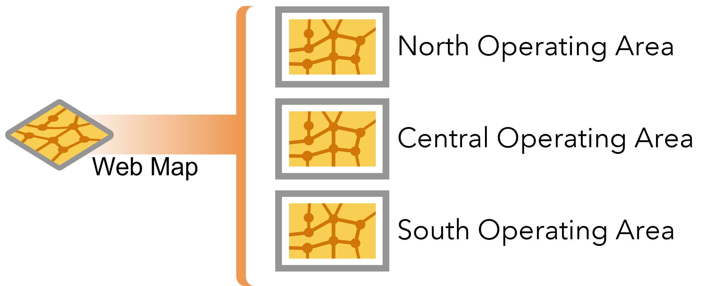

Each offline map area is an extraction of the web map defined data, for a specified geographic extent. A utility’s region or operating area is a natural subdivision of the utility’s full territory to define the geographic extent of each offline map area. This extraction of the data is stored with Portal. Each service in the web map will create a separate SQLite database, and the basemap will be written to a vector tile package.
When the offline map area is initially defined a scheduled task will regularly update the portal’s stored copy of the data with changes made to the core data repositories.
NOTE: A single web map can support up to 16 offline map areas. If more offline map areas are required, simply copy the original web map then define additional offline map areas.

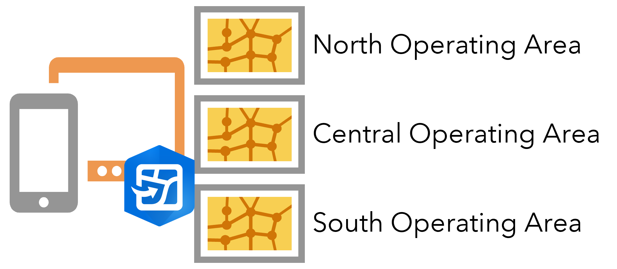

Deploying to the Mobile Device
With the offline map areas created, it is now time to deploy to the utility field workers.
This is where supporting foreign crews with the utility information they need to understand where the utility infrastructure was before the disaster event becomes much simpler. A free download of the ArcGIS Field Maps application from the Google Play, Amazon Store, or Apple Store gets the mobile software onto their phone or tablet.
An email to the foreign utility worker with a login and password to the ArcGIS Portal hosting the offline map areas will give the utility field worker secure access to the asset data they need.
Once logged into the ArcGIS Field Maps application, the utility field workers and the foreign utility workers will see the groups and content the GIS/IT department has approved them to access.

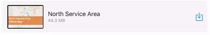

Within this group will be the web map and its listing of defined offline map areas. A simple tap on the download icon will initiate the download of the offline map areas the worker needs.

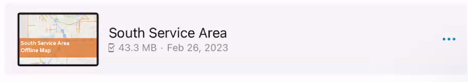

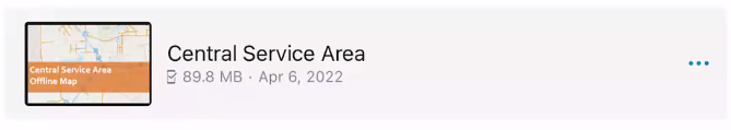

Once downloaded the offline map areas will display the total storage space required on the device, as well as the date when the offline map area was last synchronized.
