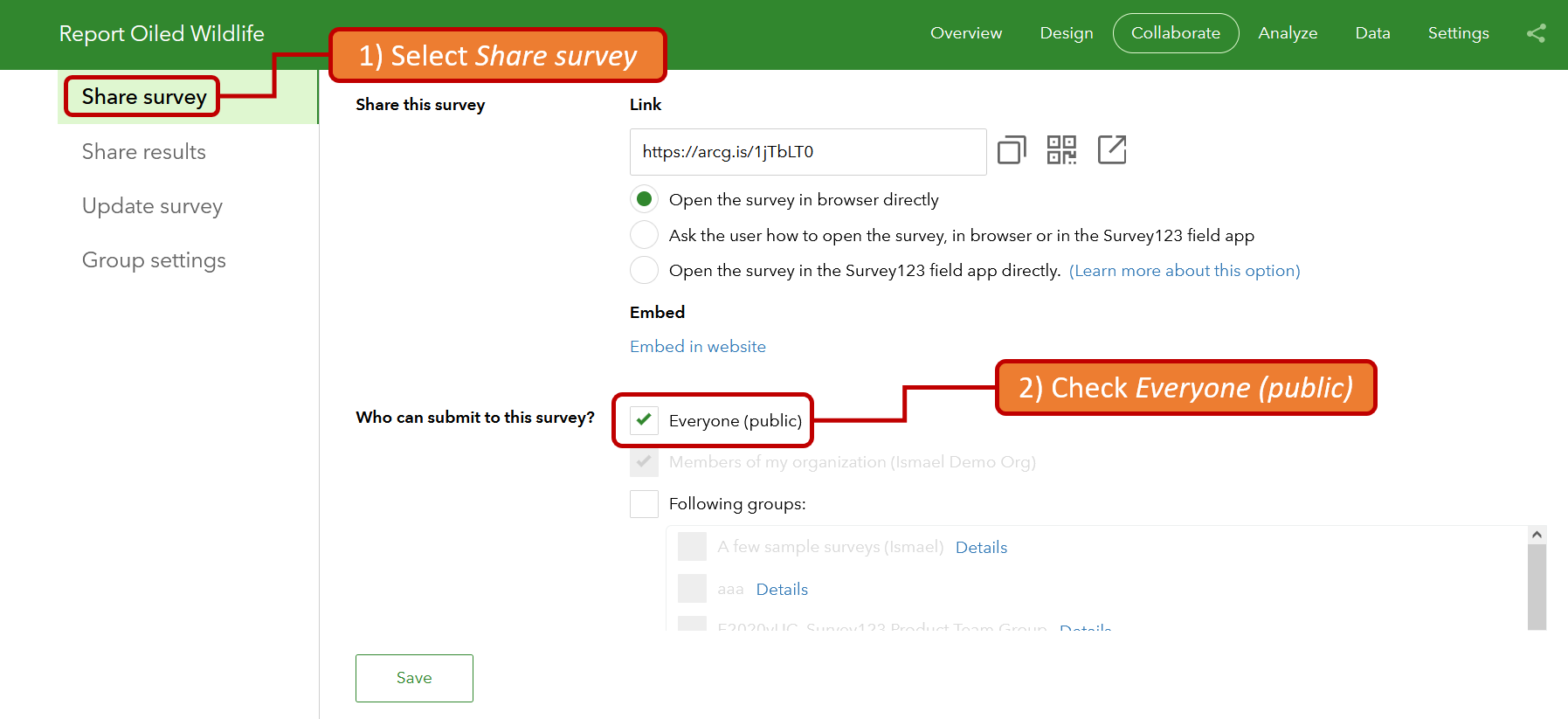

- Sign in to the Survey123 website at survey123.arcgis.com.

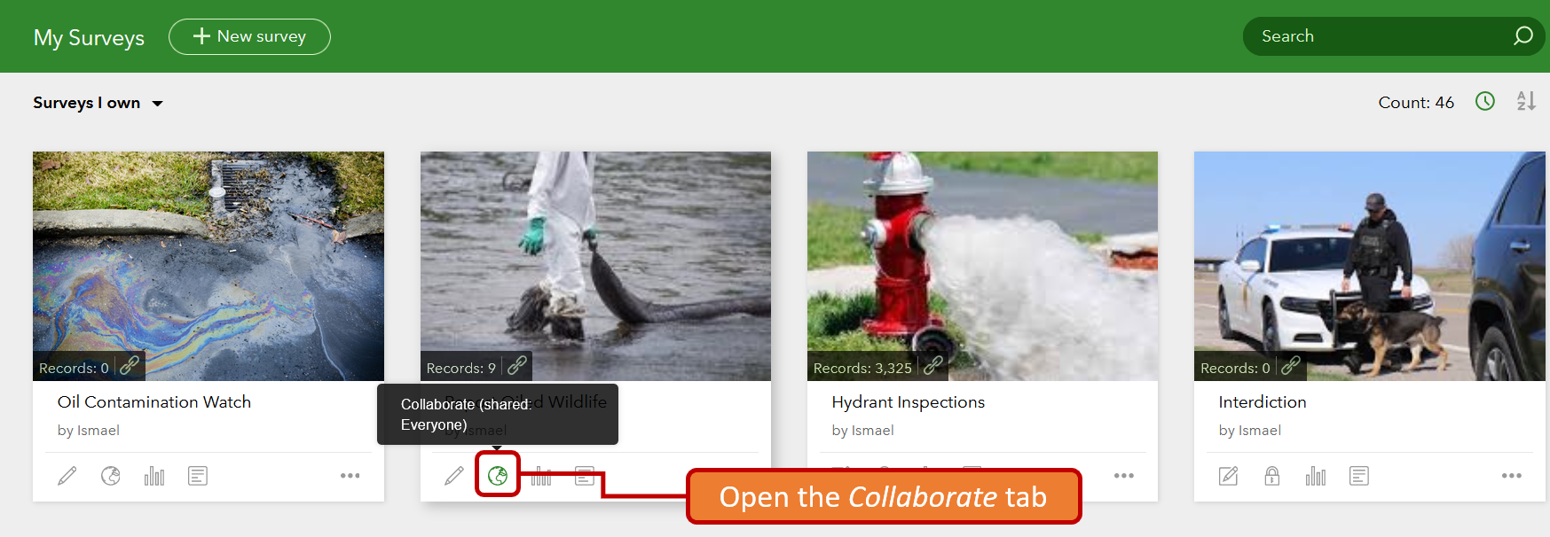

- From the survey gallery, open the Collaborate tab of your survey
- The Share survey panel controls who can submit data to your survey. While in the Share survey panel, look for the section named Who can submit to this survey? and check the Everyone (Public) option to share your survey publicly.
You will not be able to share a survey publicly if your role in the organization lacks the Share items publicly privilege, or if the organization has disabled the Allow users to share items publicly security setting.

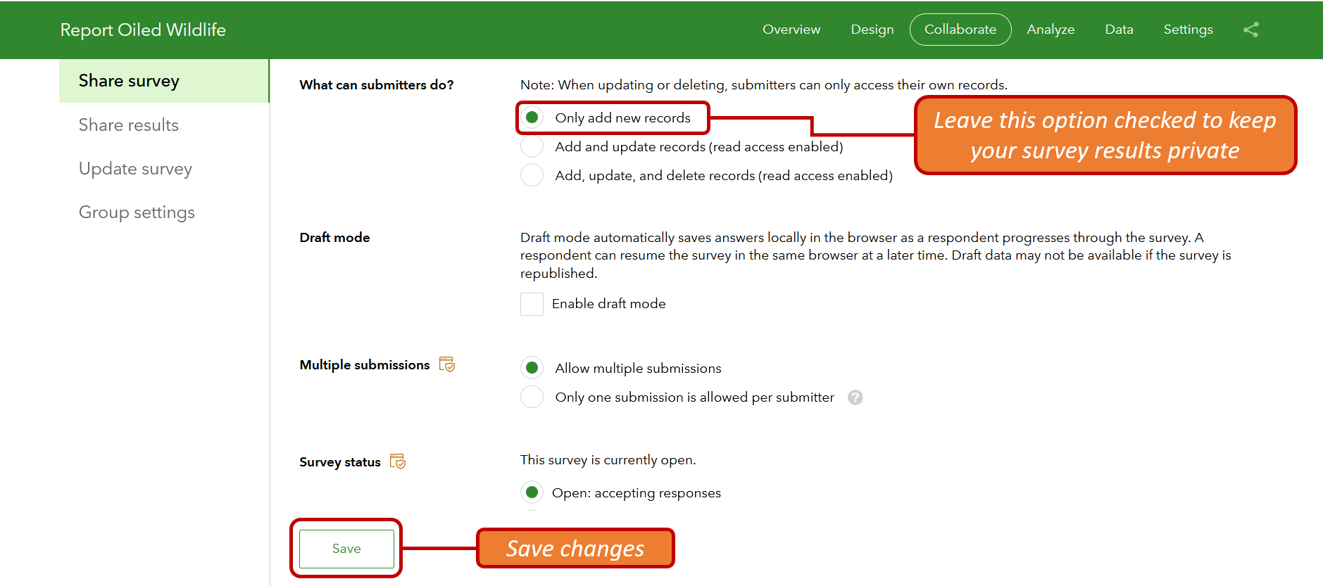

- Scroll down the page and look for the What can submitters do? section. Note that by default, the selected option is 'Only add new records'. This guarantees that your survey layer will not expose your survey results.
- Click on Save at the bottom to persist all changes.
At this moment, your survey is shared publicly, allowing anyone to submit data through both the Survey123 web and field apps. You can get the link to your survey from the top of the Collaborate tab and distribute the link with your users. Since you have restricted access to 'Only add new records' in the Collaborate tab, it will not be possible to query, update, delete or download your survey data through the Survey123 web or field apps. Your survey's feature layer will also be secure, preventing any type of access (other than adding new records), from other Esri, third party apps or programmatic access.

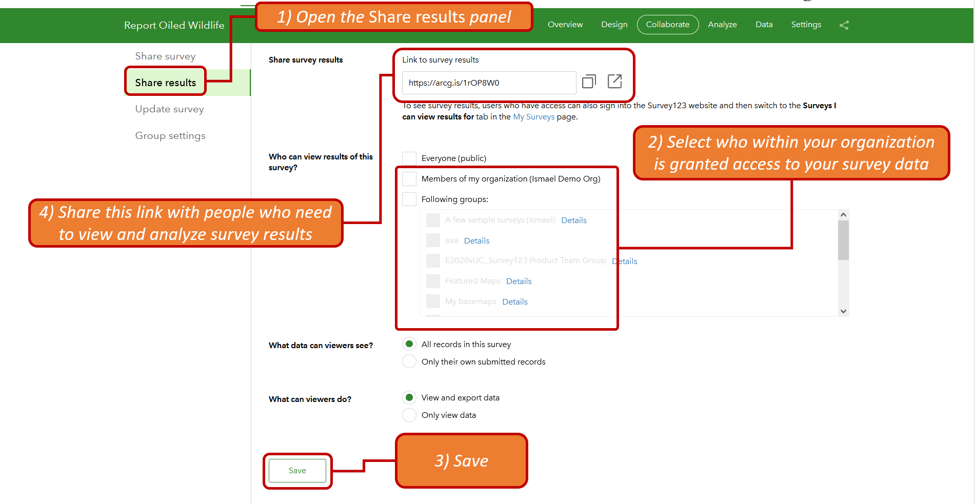

Your survey data is useful for people to make decisions. Sooner or later you will likely want to share that data with people who need it. Through the Collaborate tab, you can privately share this data with members of your ArcGIS organization so they can view, analyze and even download the data from the Survey123 website.
- From the Collaborate tab of your survey, switch to the Viewer panel.
- Look for the "Who can view results of this survey?" and check the groups within your organization that should have access to your survey's data.
- Click on Save to persist changes.
Now that you have shared the results of your survey, users with access to the survey results will be able to look at the data from the Survey123 website using the Overview, Data and Analyze tabs of the Survey123 website.
You can get the survey results link from the top of the Collaborate tab and distribute it within your organization. Alternatively ask users to login into the survey123.arcgis.com website to see the survey results.

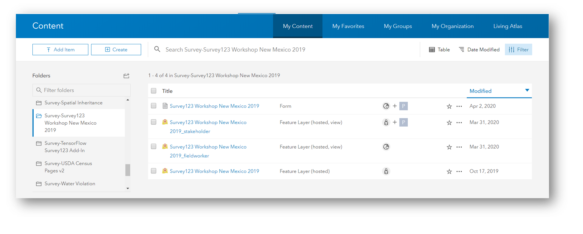

- Log into the arcgis.com website and click on the My Content tab.
- Look for your survey's folder in the Content tab. Note that Survey123 folders carry a Survey prefix followed by the name of your survey. It will look something like this:
Here is a brief explanation of the items in your survey directory:
- A form item: This ArcGIS item contains the definition of your survey with its questions, rules, look and feel and other properties. This item allows end-users to use your form from the Survey123 web or field apps.
- A hosted feature layer view with a "_fieldworker" suffix in its name. This item is created by the Survey123 web designer when the survey is first published. This item is used by the Survey123 web and field apps to submit data into ArcGIS. Permissions and sharing for this item are controlled via the Share survey panel in the Collaborate tab of the Survey123 website.
- A hosted feature layer view with a "_stakeholder" suffix in its name. This item is created by the Survey123 website when the survey results are shared through the Collaborate tab. This item is used to control access to the survey results through the Survey123 website. If the Share results panel of the Collaborate tab has not been used to share the survey results, this item will be missing.
- A hosted feature layer. This is where the actual data of your survey is stored. This item is created by the Survey123 web designer when the survey is published. You should never share this item.

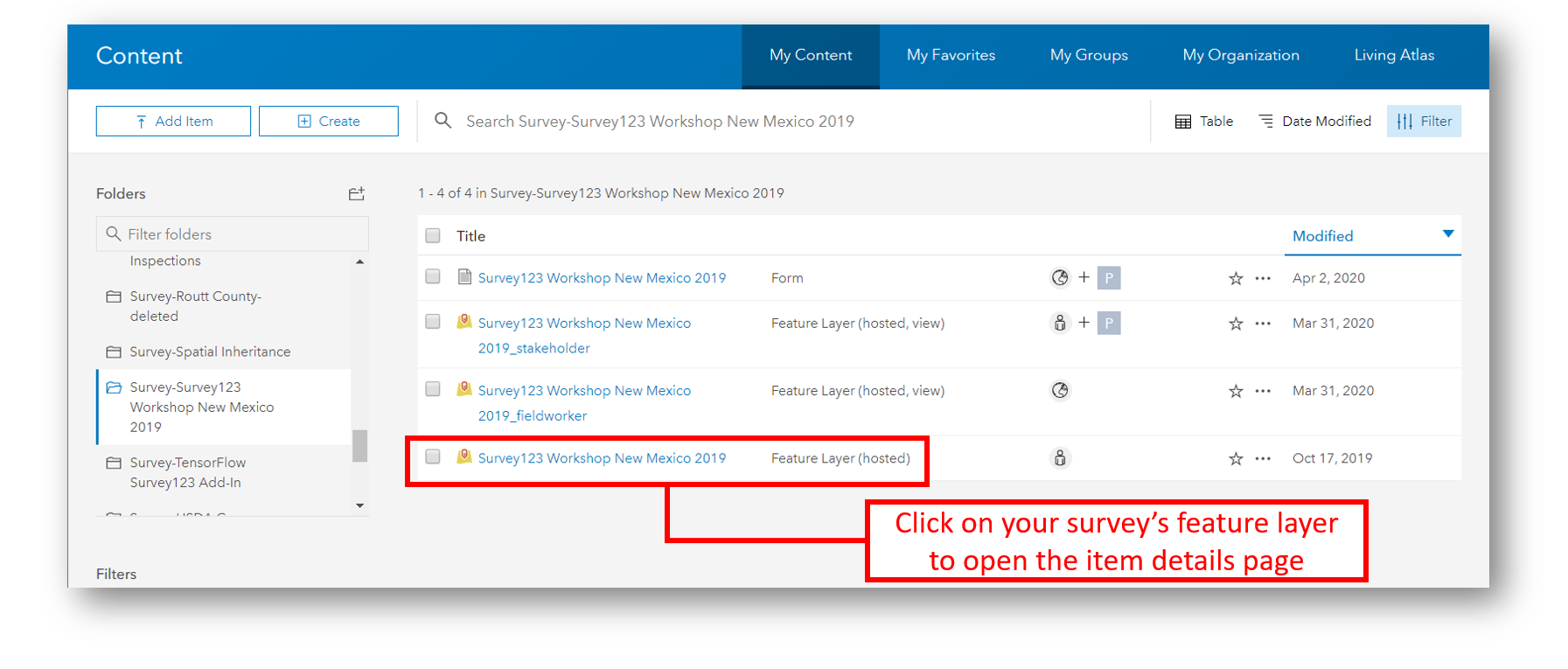

- From your survey's folder in My Content, click on your survey's feature layer to open it's item details page.
- Next click on Create View Layer.
