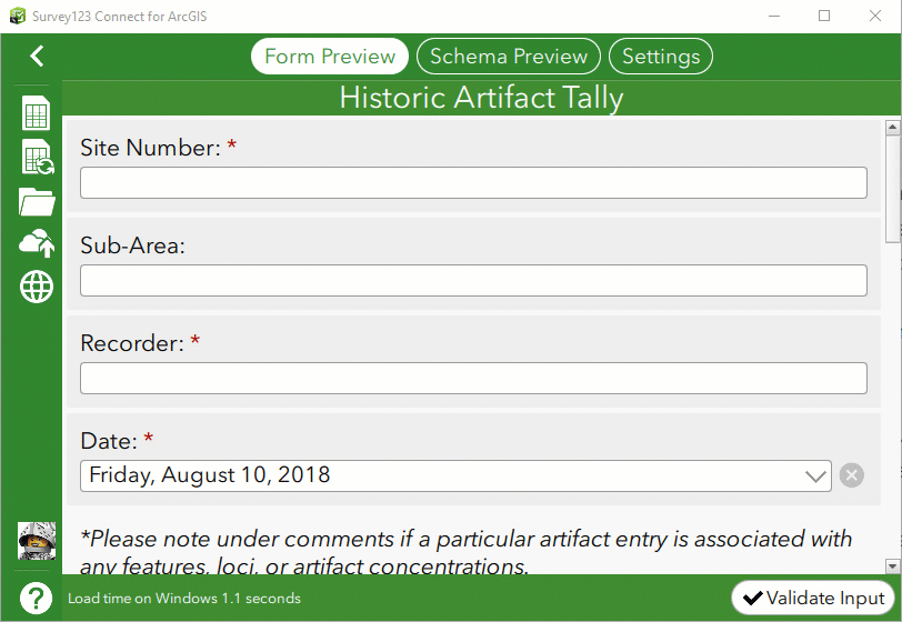

For context, Survey123 Connect includes a number of settings that let the author of a survey control the size of images uploaded into ArcGIS. The Image settings can be accessed as shown in the next animation. Up until this release, the 'Unrestricted' mode was not working properly because images where being reduced in size.
The image size setting applies to photos taken with the built-in Survey123 camera. Images selected from your photo gallery in the device are uploaded to ArcGIS without modification.
