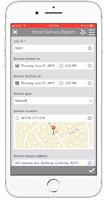

In the Street Service Report survey example in the right side, you will appreciate that the photo taken from Survey123 automatically includes the Job ID as well as the date and time when the photo was taken.
This information is part of the image, it is a photo watermark.

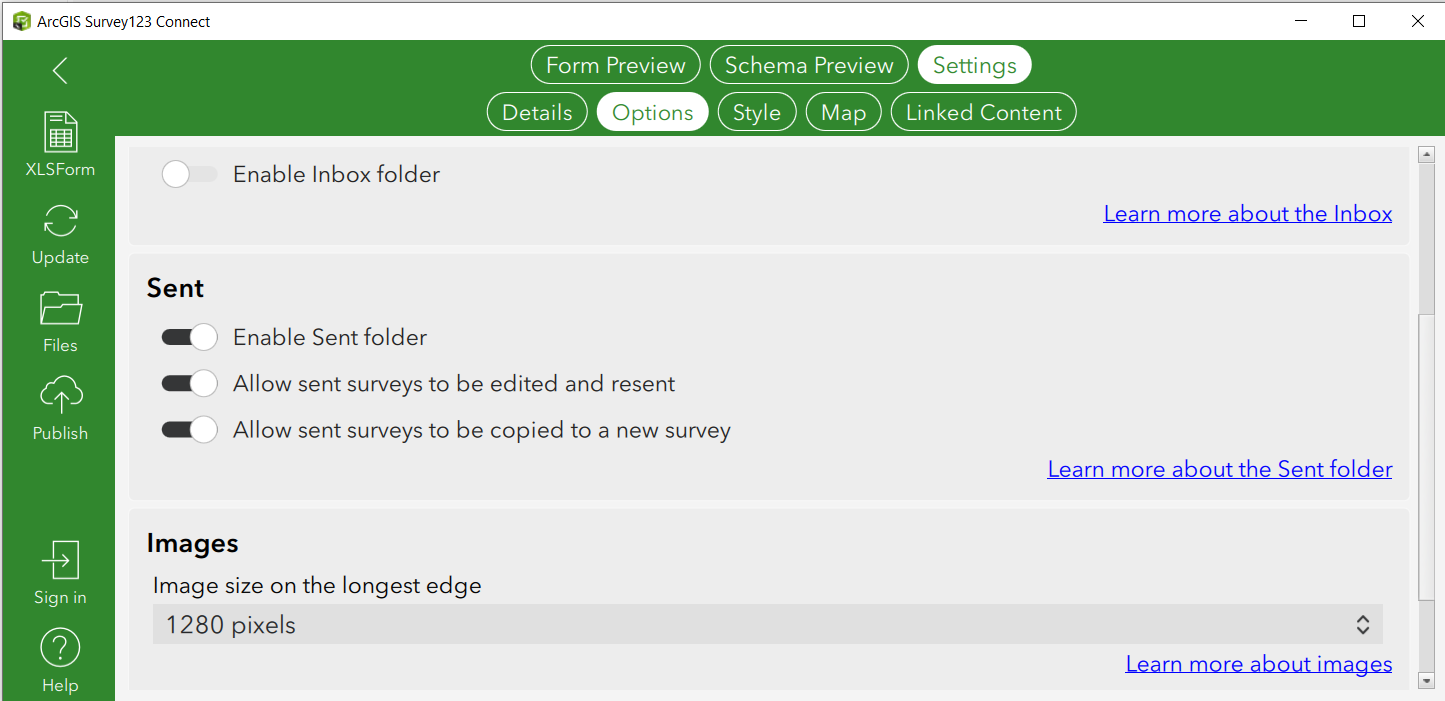

By default, Survey123 Connect always sets your image size to 640px on the longest edge. In a 640px image, text at 12 pixels in size will show pixelated. You could increase the size to 16 pixels for better results. If you change the image size to 1280, at 12px your text will be very small; you may want to change then the size to 24 or 26.
The default image size set by Connect (640px) is not ideal for watermarking. Give it a go in your own, but I typically use 1280px because otherwise there is barely any room for the watermark.

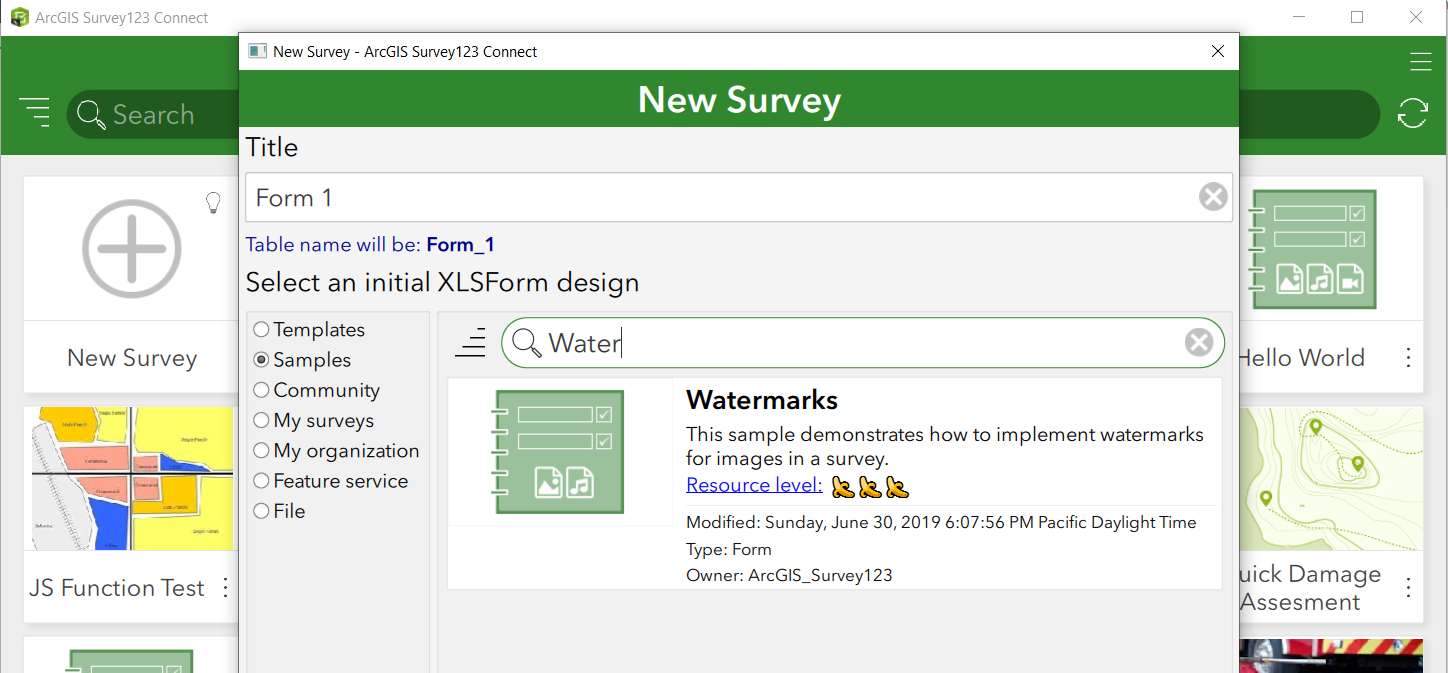

A great resource to see many photo watermark examples is the Watermarks XLSForm sample included in Survey123 Connect. It includes over 20 different watermarks across multiple pages.
