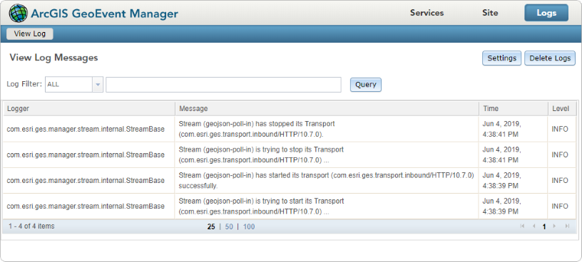

The GeoEvent Manager Logging Interface
ArcGIS GeoEvent Server uses Apache Karaf, a lightweight flexible container to support its Java runtime environment. A powerful logging system, based on OPS4j Pax Logging, is included with Apache Karaf.
The GeoEvent Manager web application includes a simple user-interface for the ops4j logging system. You can use this interface to see the most recent messages logged by different components of ArcGIS GeoEvent Server. The UI illustrated below caches up to 500 logged messages and allows you to scroll through logged messages specifying how many messages should be listed on a page, select a specific type of logged message (e.g. DEBUG, INFO, WARN, or ERROR) as well as perform keyword searches.
A significant limitation of this logging interface is that only the most recent 500 logged messages are maintained in its cache, so review and keyword searches you perform are limited to recently logged messages. This means that the velocity and volume of event records being processed as well as the number of GeoEvent Services, inputs, and outputs you have configured can affect (and limit) your ability to isolate logged messages of interest. A valuable debugging technique is to locate the actual log file on disk and open it in a text editor.

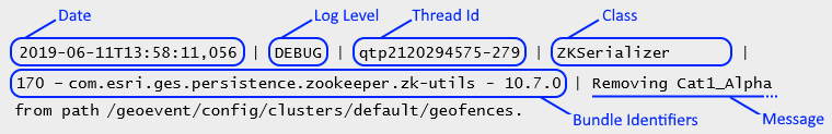

The anatomy of a logged message
Before we conclude our discussion on configuring the application logger I would like to briefly discuss the format of logged messages. The logged message format is configurable and logged messages by default have six parts. Each part is separated by a pipe ( | ) character.
The thread identifier default specification (see illustration below) has a minimum of 16 characters but no maximum length; some thread identifiers can be quite long. The class identifier spec includes a precision which limits the identifier to the most significant part of the class name. In the illustration above the fully-qualified class identifier com.esri.ges.fabric.core.ZKSerializer has been shortened to simply ZKSerializer. We will discuss the impact of this more in a later blog.
You can edit the org.ops4j.pax.logging.cfg configuration file to specify different patterns for the appender. You should refer to https://logging.apache.org/log4j/2.x/manual/layouts.html#PatternLayout in the Apache logging services on-line help before modifying the default appender pattern layout illustrated below.
# Common pattern layout for appenders log4j2.pattern = %d{ISO8601} | %-5p | %-16t | %-32c{1} | %geoeventBundleID - %geoeventBundleName - %geoeventBundleVersion | %m%n log4j2.out.pattern = \u001b[90m%d{HH:mm:ss\.SSS}\u001b[0m %highlight{%-5level}{FATAL=${color.fatal}, ERROR=${color.error}, WARN=${color.warn}, INFO=${color.info}, DEBUG=${color.debug}, TRACE=${color.trace}} \u001b[90m[%t]\u001b[0m %msg%n%throwable |
