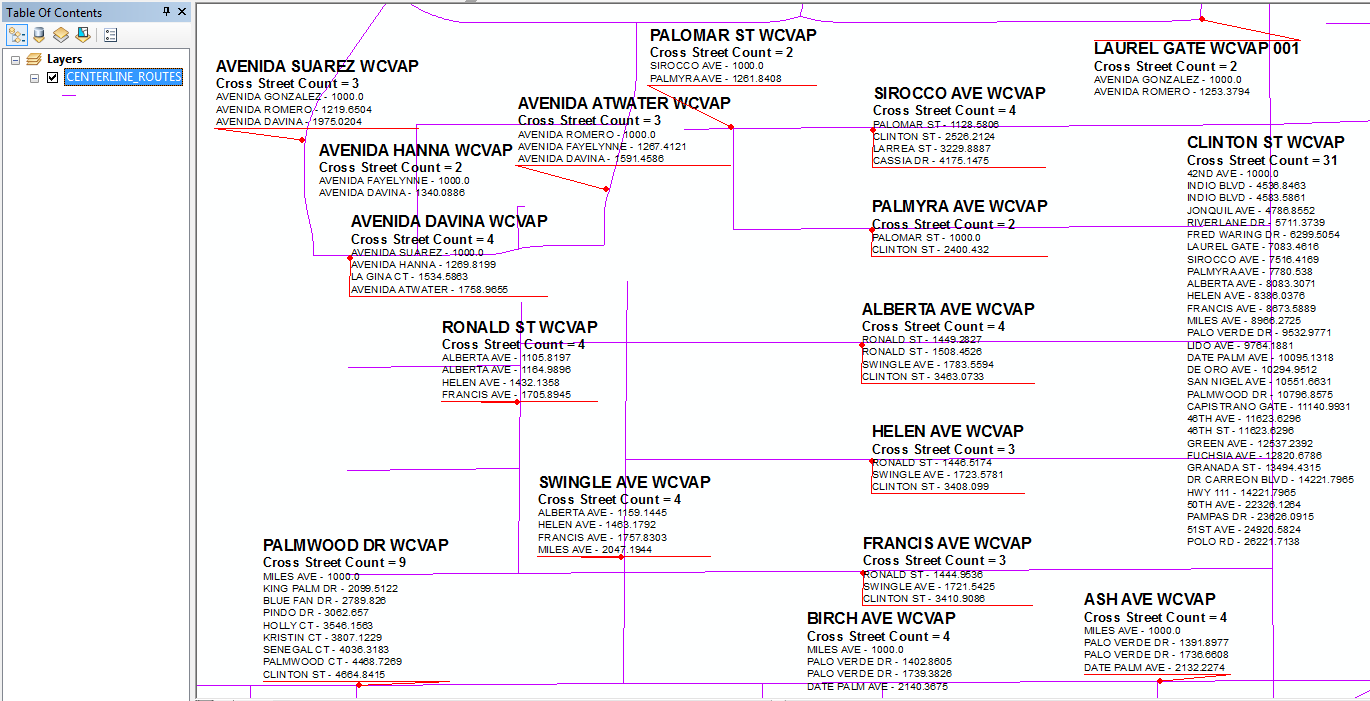

Example 1:Β The Fundamental Code to Create Labels Using this Technique
The labels shown in this picture were created by the code below.Β The related intersection event table used to create these labels contains over 130,000 records, all of which are read into the dictionary when the first label is processed.Β These labels took less than 9 seconds to draw.
To use the code below I went to the Label tab of the Routes and checked the Label check box.Β Then I pressed the Expression button for the labels, I changed the Label Parser from VBScript to Python.Β After checking the Advanced expression option, I placed the code below in the expression editor.Β This expression creates a label for my layer of linear referenced Routes shown above and includes data from a related table of intersection linear reference events.Β It lists the Route ID (ROUTE_NAME) in the header of the label in 12 point Bold font.Β Under that I show a summary count value of the number of intersection cross street names contained in the related table in 10 point Bold font.Β Then I list the related cross street names and their event measure value for each intersection in the regular 8 point font.Β The list of cross streets is sorted as a list based on the measures so that they appear in driving order going in the direction of the route's measure orientation.

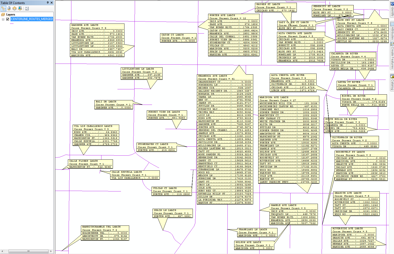

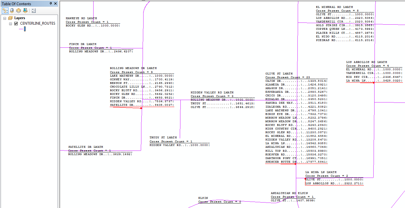

The labels shown represent only one of the possible ways I could have summarized and/or listed the related feature class/table data.Β A semi-tabular presentation is possible if I use a fixed-spaced font like Courier New.Β A method for making a tabular style label was given in this postβ by Jennifer Horsman; however, her code used VBScript and used an inefficient search cursor algorithm.Β Below I have adapted her code to use Python and the much more efficient dictionary algorithm shown above.

Example 3: Another Table Style Label Alternative
Here is an alternative table style layout.Β The code below includes all of the code shown in the previous example through line 36, but replaces the code that began in line 37 in the code for example 2 as follows:.
<SPAN class="comment token"># variables to adjust table cell sizes </SPAN>
iMaxLbl1Sz <SPAN class="operator token">=</SPAN> <SPAN class="number token">0</SPAN>
iMaxLbl2Sz <SPAN class="operator token">=</SPAN> <SPAN class="number token">0</SPAN>
iSpace <SPAN class="operator token">=</SPAN> <SPAN class="number token">5</SPAN>
<SPAN class="comment token"># determine if the label key is in the dictionary </SPAN>
<SPAN class="keyword token">if</SPAN> labelKey <SPAN class="keyword token">in</SPAN> relateDict<SPAN class="punctuation token">:</SPAN>
<SPAN class="comment token"># sort the list of the list of fields </SPAN>
sortedList <SPAN class="operator token">=</SPAN> sorted<SPAN class="punctuation token">(</SPAN>relateDict<SPAN class="punctuation token">[</SPAN>labelKey<SPAN class="punctuation token">]</SPAN><SPAN class="punctuation token">)</SPAN>
<SPAN class="comment token"># process the sorted list to determine cell spacing </SPAN>
<SPAN class="keyword token">for</SPAN> fieldValues <SPAN class="keyword token">in</SPAN> sortedList<SPAN class="punctuation token">:</SPAN>
strLabel1 <SPAN class="operator token">=</SPAN> fieldValues<SPAN class="punctuation token">[</SPAN><SPAN class="number token">1</SPAN><SPAN class="punctuation token">]</SPAN>
strLabel2 <SPAN class="operator token">=</SPAN> <SPAN class="string token">'{:.4f}'</SPAN><SPAN class="punctuation token">.</SPAN>format<SPAN class="punctuation token">(</SPAN>fieldValues<SPAN class="punctuation token">[</SPAN><SPAN class="number token">0</SPAN><SPAN class="punctuation token">]</SPAN><SPAN class="punctuation token">)</SPAN>
<SPAN class="keyword token">if</SPAN> <SPAN class="punctuation token">(</SPAN>len<SPAN class="punctuation token">(</SPAN>strLabel1<SPAN class="punctuation token">)</SPAN> <SPAN class="operator token">></SPAN> iMaxLbl1Sz<SPAN class="punctuation token">)</SPAN><SPAN class="punctuation token">:</SPAN>
iMaxLbl1Sz <SPAN class="operator token">=</SPAN> len<SPAN class="punctuation token">(</SPAN>strLabel1<SPAN class="punctuation token">)</SPAN>
<SPAN class="keyword token">if</SPAN> <SPAN class="punctuation token">(</SPAN>len<SPAN class="punctuation token">(</SPAN>strLabel2<SPAN class="punctuation token">)</SPAN> <SPAN class="operator token">></SPAN> iMaxLbl2Sz<SPAN class="punctuation token">)</SPAN><SPAN class="punctuation token">:</SPAN>
iMaxLbl2Sz <SPAN class="operator token">=</SPAN> len<SPAN class="punctuation token">(</SPAN>strLabel2<SPAN class="punctuation token">)</SPAN>
<SPAN class="comment token"># clean up the fieldValues variable once the for loop is done </SPAN>
<SPAN class="keyword token">del</SPAN> fieldValues
<SPAN class="comment token"># My label has a key value header followed by a record count </SPAN>
expression <SPAN class="operator token">=</SPAN> <SPAN class="string token">"<CLR red='255' green='255' blue='255'>_</CLR>"</SPAN> <SPAN class="operator token">+</SPAN> labelKey <SPAN class="operator token">+</SPAN> <SPAN class="string token">"<CLR red='255' green='255' blue='255'>"</SPAN> <SPAN class="operator token">+</SPAN> <SPAN class="string token">'_'</SPAN> <SPAN class="operator token">*</SPAN> <SPAN class="punctuation token">(</SPAN>iMaxLbl1Sz <SPAN class="operator token">+</SPAN> iMaxLbl2Sz <SPAN class="operator token">+</SPAN> iSpace <SPAN class="operator token">+</SPAN> <SPAN class="number token">2</SPAN> <SPAN class="operator token">-</SPAN> len<SPAN class="punctuation token">(</SPAN><SPAN class="string token">"_"</SPAN><SPAN class="operator token">+</SPAN>labelKey<SPAN class="punctuation token">)</SPAN><SPAN class="punctuation token">)</SPAN> <SPAN class="operator token">+</SPAN> <SPAN class="string token">"</CLR>"</SPAN>
expression <SPAN class="operator token">+=</SPAN> <SPAN class="string token">"\n_<UND>Cross Street Count = {}</UND>"</SPAN><SPAN class="punctuation token">.</SPAN>format<SPAN class="punctuation token">(</SPAN>len<SPAN class="punctuation token">(</SPAN>sortedList<SPAN class="punctuation token">)</SPAN><SPAN class="punctuation token">)</SPAN> <SPAN class="operator token">+</SPAN> <SPAN class="string token">'_'</SPAN> <SPAN class="operator token">*</SPAN> <SPAN class="punctuation token">(</SPAN>iMaxLbl1Sz <SPAN class="operator token">+</SPAN> iMaxLbl2Sz <SPAN class="operator token">+</SPAN> iSpace <SPAN class="operator token">+</SPAN> <SPAN class="number token">2</SPAN> <SPAN class="operator token">-</SPAN> len<SPAN class="punctuation token">(</SPAN><SPAN class="string token">'_Cross Street Count = {}'</SPAN><SPAN class="punctuation token">.</SPAN>format<SPAN class="punctuation token">(</SPAN>len<SPAN class="punctuation token">(</SPAN>sortedList<SPAN class="punctuation token">)</SPAN><SPAN class="punctuation token">)</SPAN><SPAN class="punctuation token">)</SPAN><SPAN class="punctuation token">)</SPAN>
<SPAN class="comment token"># process the sorted list </SPAN>
k1 <SPAN class="operator token">=</SPAN> <SPAN class="punctuation token">(</SPAN>iMaxLbl1Sz <SPAN class="operator token">-</SPAN> len<SPAN class="punctuation token">(</SPAN>strLabel1<SPAN class="punctuation token">)</SPAN><SPAN class="punctuation token">)</SPAN> <SPAN class="operator token">+</SPAN> <SPAN class="number token">2</SPAN>
k2 <SPAN class="operator token">=</SPAN> iSpace <SPAN class="operator token">+</SPAN> <SPAN class="punctuation token">(</SPAN>iMaxLbl2Sz <SPAN class="operator token">-</SPAN> len<SPAN class="punctuation token">(</SPAN>strLabel2<SPAN class="punctuation token">)</SPAN><SPAN class="punctuation token">)</SPAN> <SPAN class="operator token">-</SPAN> <SPAN class="number token">3</SPAN>
<SPAN class="comment token"># append related data to the label expression </SPAN>
<SPAN class="comment token"># my label shows a list of related </SPAN>
<SPAN class="comment token"># cross streets and measures sorted in driving order </SPAN>
expression <SPAN class="operator token">+=</SPAN> <SPAN class="string token">'\n_<UND>'</SPAN> <SPAN class="operator token">+</SPAN> strLabel1 <SPAN class="operator token">+</SPAN> <SPAN class="string token">"."</SPAN> <SPAN class="operator token">*</SPAN> k1
expression <SPAN class="operator token">+=</SPAN> <SPAN class="string token">"|"</SPAN>
expression <SPAN class="operator token">+=</SPAN> <SPAN class="string token">"."</SPAN> <SPAN class="operator token">*</SPAN> k2 <SPAN class="operator token">+</SPAN> strLabel2 <SPAN class="operator token">+</SPAN> <SPAN class="string token">"</UND>_"</SPAN>
<SPAN class="comment token"># clean up all list variables after completing the for loops </SPAN>
<SPAN class="keyword token">del</SPAN> sortedList<SPAN class="punctuation token">,</SPAN> fieldValues
<SPAN class="keyword token">else</SPAN><SPAN class="punctuation token">:</SPAN>
expression <SPAN class="operator token">+=</SPAN> <SPAN class="string token">'\n_<UND>Cross Street Count = 0</UND>'</SPAN>
<SPAN class="comment token"># return the label expression to display </SPAN>
<SPAN class="keyword token">return</SPAN> expression
