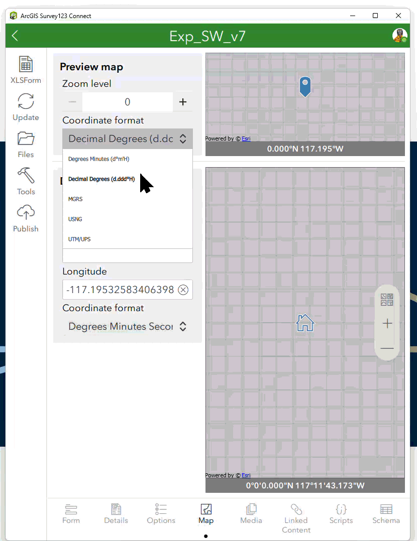

As per the attached gif, the Survey123 Connect geographical coordinate decimal degrees are named confusingly. The H character at the end of the dropdown list creates confusion.
Can (1) the H be removed from the dropdown list and (2) it's longer preceeding name be shortened so it fully displays? E.g. Decimal Degrees (d.ddd°H) becomes Dec Deg (d.ddd°). Similar rationalisation is needed for the other formats.
Furthermore, I have a marine survey background and initially mistook this for something else. I realise it is an option missing from the dropdown list. In hydrographic surveying and marine navigation it is common to record positions in terms of decimal minutes of arc. This is generally expressed as ddd°m.m' and in notation (e.g. sextant booking, waypoint records) written as ddd°m'.m where the ' character preceeds the decimal point.
I recommend also adding a decimal minutes of arc option in the form ddd°m.mmm'.
