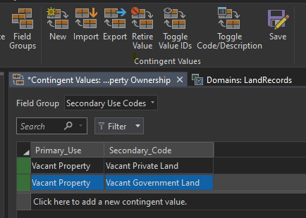

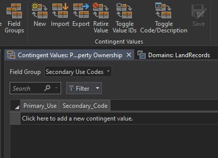

My issue is that I am able to add new contingent value "pairs" using the drop downs in the Contingent Values window, and can then hit the save button, however upon "saving," they are just removed and I am left with a blank list again. I am not getting any error messages or warnings, and the colored indicator square in the table is green.

First image shows the CVs added, second image shows them disappear immediately after save. This is coming straight out of "Focus on Geodatabases in ArcGIS Pro" (2019) if the field group, fields, or individual CVs look familiar.

UPDATE:
Adding via arcpy does seem to work. Interestingly, once one has been added, doing it manually via the GUI seems to allow saving as well. This probably solves my issue, but I'd be curious if others have the same problem.
