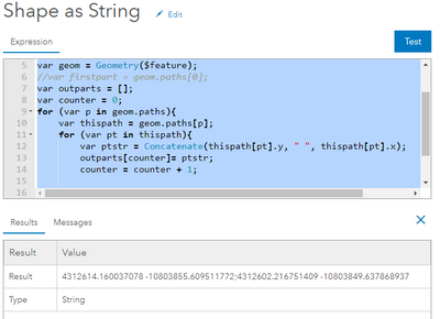

I am using the following code to get the geometry data:
It's from this post: https://community.esri.com/t5/arcgis-survey123-questions/survey123-with-collector-set-geotrace/m-p/784059#M6798
@JamesTedrick is there a trick or step I'm missing?
