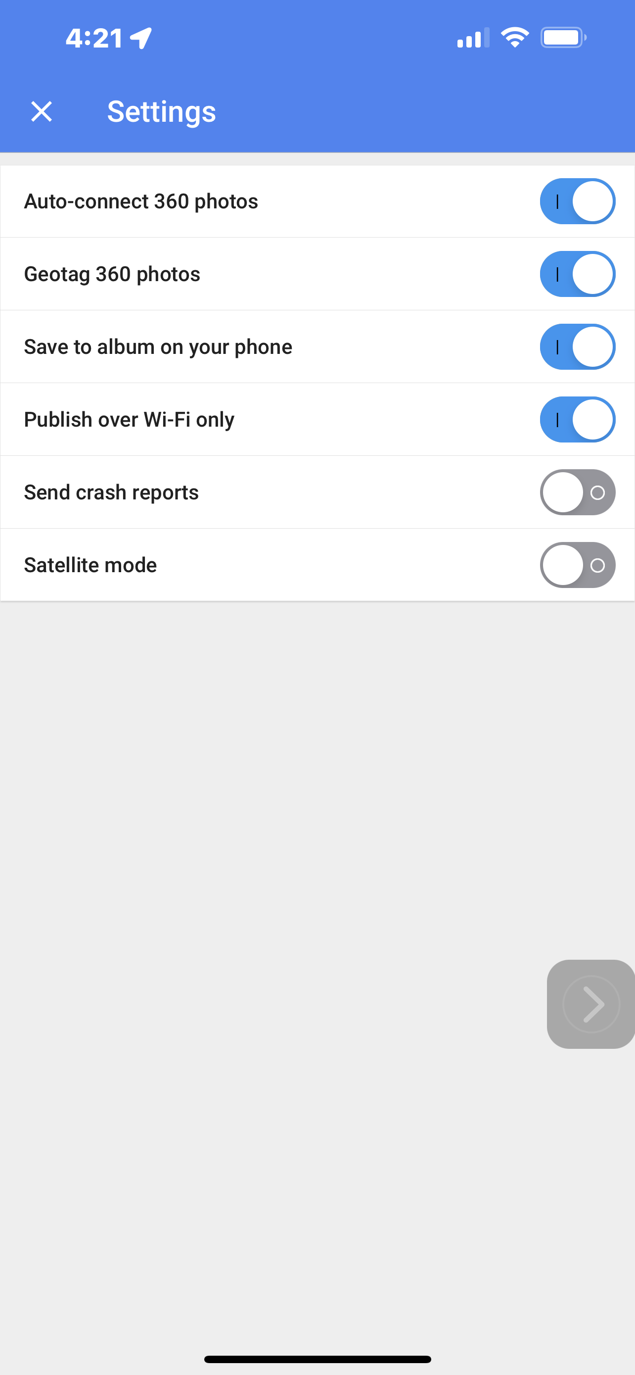

Download the free app (sign in may be required). Go to the app’s settings and ensure that you’re keeping a local copy of the processed image. See screenshot.

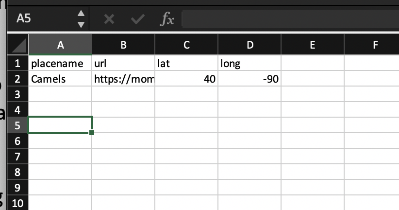

On Momento360, click an image to find the sharing link. Select “Share/Embed link”. Copy the URL and paste into your spreadsheet, like the image below.
In this case, I’m going to create just one record. Save your spreadsheet as a .CSV file – ideally on your desktop. Log into your ArcGIS Online organization.

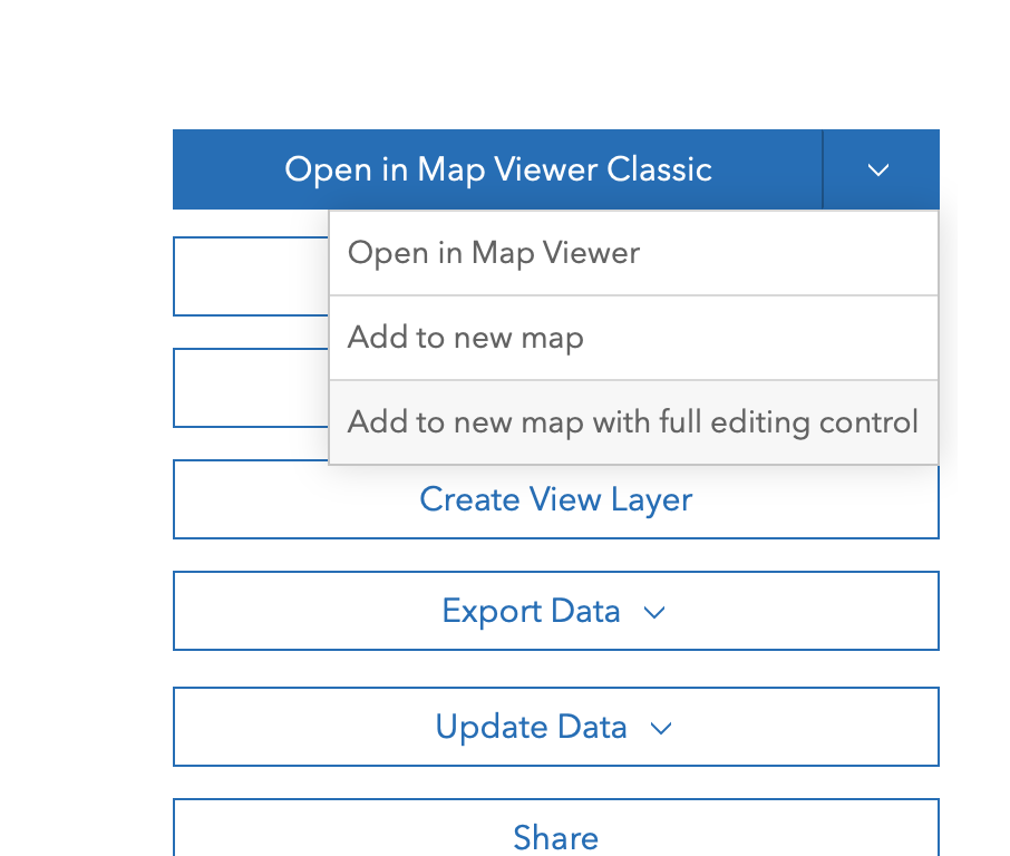

- I edit my feature service using the classic map viewer in cases like this.
- Select “Add to new map with full editing controls”.

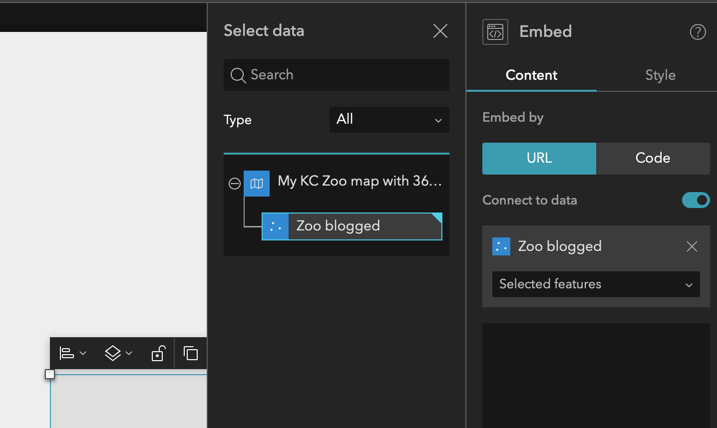

- Click the widget box on the canvas, Set the map source in the right-most panel by pressing “Select Map”. Click the “Add New Data” link near the bottom. Find your newly created map. Click the map name in the list to “activate” it. The map should now appear in your Experience Builder canvas.
- Click and drag an “Embed” widget to the Experience Builder canvas.

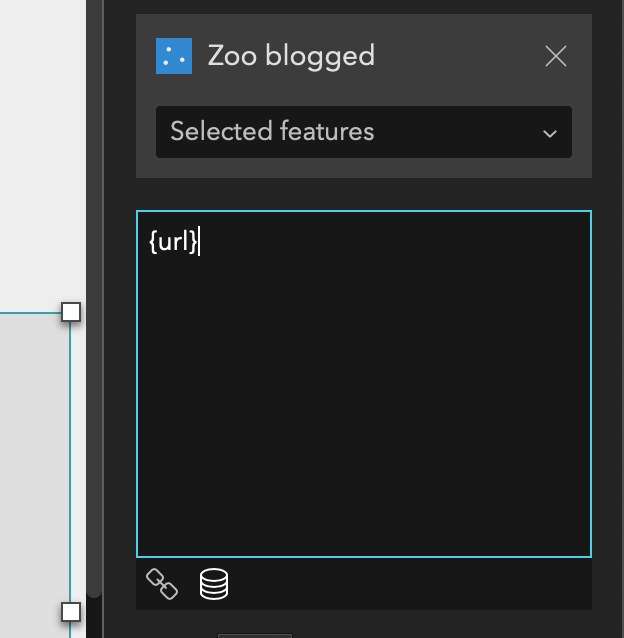

- Click the embed widget displayed on the canvas. In the Embed window on the right, click the slider for “Connect to Data”. Click the button, “Select data”. Your map name should appear. Press the plus button to open the layer list of the map. Click the layer with your points and image links.
- Back to the right, set the pull down beneath your layer name to “Selected features”. See image below.
Click the database icon (looks like a small can with horizontal stripes) and select your 360 image URL column. This should paste the name of your linked data field into the window. The field name will have curly braces around it, as you can see below.
