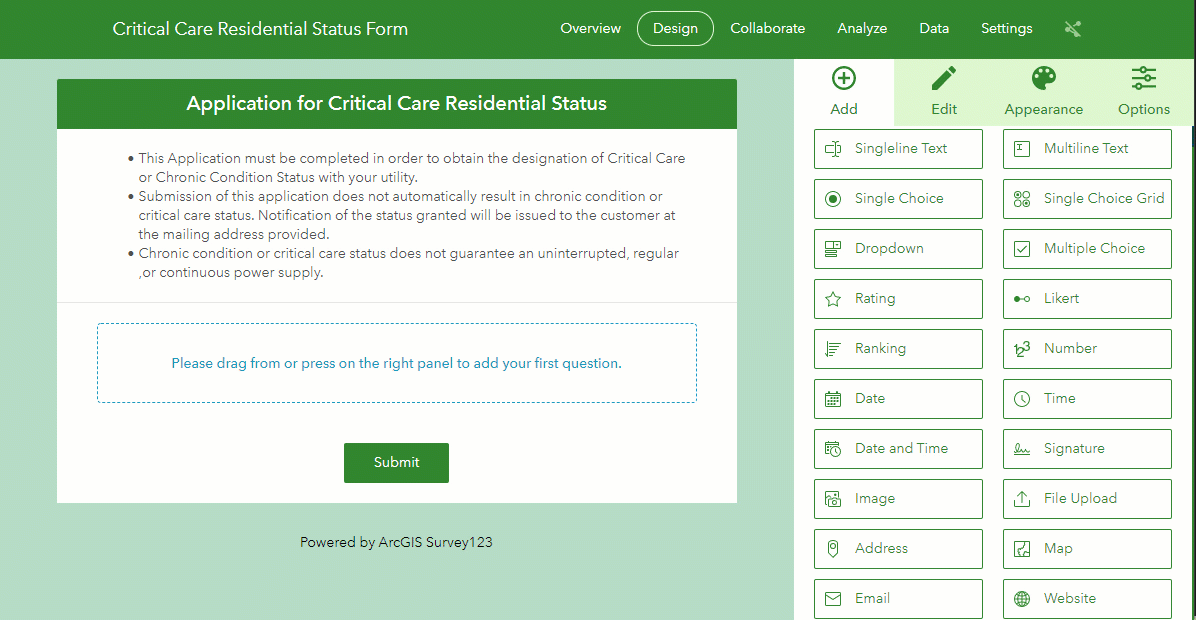

The address question type is available in the Survey123 web designer. To get started, add this question into your survey design as shown in the animation below.
After you set the label of your question and optionally its hint, an important decision to make is what data you want to submit:
- Address text and point geometry: Stores the address entered by the user as text and it also adds the address location to a map. This option is great if you want to view and analyze survey responses geographically. Storing the location of an address as provided by the ArcGIS World Geocoding service is subject to ArcGIS Online credit consumption as described in the Credits by capability section of the ArcGIS Online help.
- Address text only: Stores the address entered as text. If you plan to collect multiple addresses in your form, or if you are already collecting a location through a map question, you will want to choose this option.

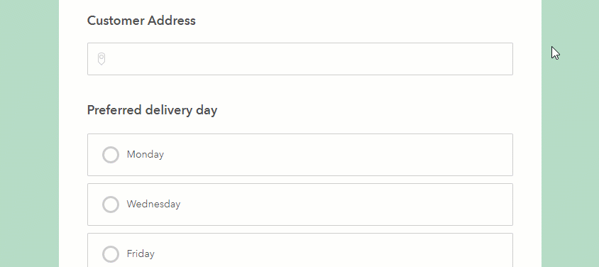

In the animation below, the locator has been configured to find addresses anywhere in the world. Note that as the user starts entering the address, the list of candidates includes addresses from various countries.

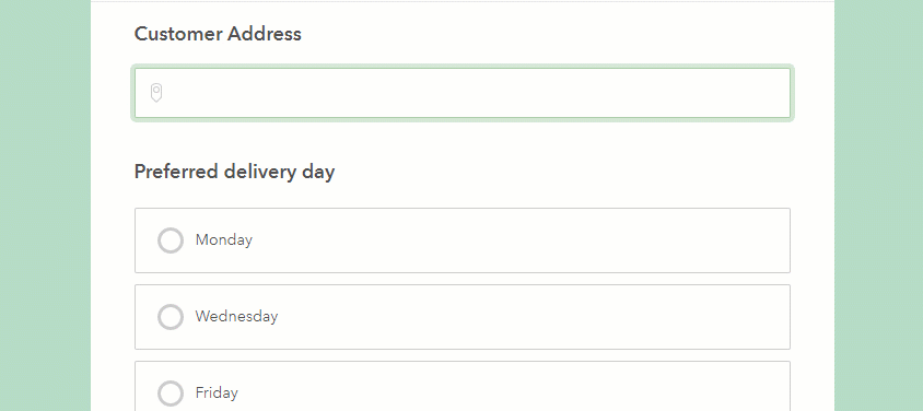

In the next animation, the same address is entered but the list of candidates is restricted to the city of Redlands. This is because the locator is configured to only look for addresses in Redlands, California.
Restricting your locator to limit address candidates within your area of interest is always a good practice. A more accurate list of candidates is a first step toward better quality data.

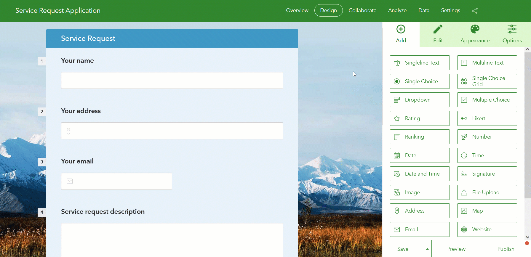

Using the Survey123 designer, you can add new questions to your form and automatically calculate them to persist these address properties.
Here is a step-by-step quick guide to show you how it's done. Say for example, you want to extract the postal code out of the address and store it in a separate hidden question:
- Add an address question to your survey.
- Add a text question. Change the label to postal code. Look for the Calculation property and click the Edit link.
- Extract the postal code from the address question and save your calculation.
- Go to the Other properties section of the text question and check the option to hide it from the survey.
The animation below shows the steps as well.

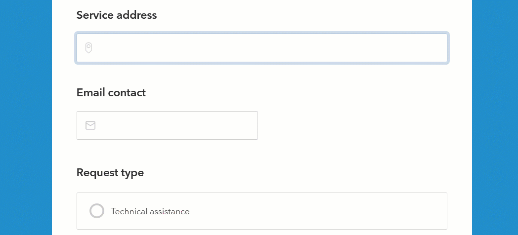

You can use this technique to extract the latitude, longitude, country code, city, postal code, the geocoding match score, the match address, and the user input text. Most of these properties are self-explanatory, but here are some additional details:
- Match score: This is a number between 0 and 100 describing how well the entered address matches an existing address in your locator. If the match is 100, the match is perfect. It is good practice to keep this score as an attribute in your survey results to understand the quality of data entered.
- Match address: This is the text representation of the address that best matches the user-entered text.
- User input text: This is the text that the user entered in the form. If the user selects an address from the list of candidates presented, the user input text will be replaced with the match address and have a score of 100. If the user does not select an address from the candidate list, the user input text will be different to the , and the score lower than 100.
