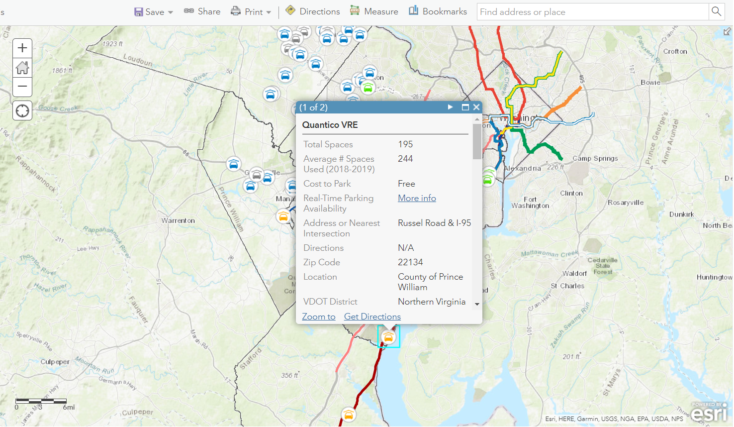

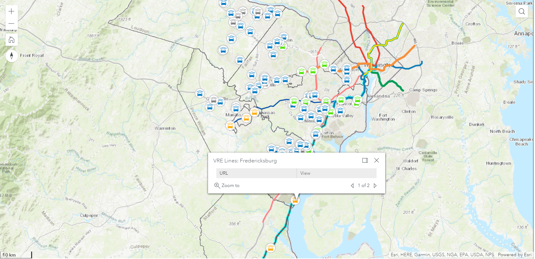

Thanks for your reply. I don't think I can share the map publicly yet, but I created a group (Map support) and added you, the webmap, and the Experience Builder to it. If you have any issues accessing that please let me know. I've also attached 2 screenshots that illustrates the problem:
  • The first screenshot shows what happens when you click on a Park& Ride in the webmap, and this is the behavior that I want in the Experience Builder. The Quantico VRE (Park & Ride) popup shows up first, and you can tell from the (1 of 2) that there is also another popup behind it.
  • The second screenshot shows the behavior when I click on the same Park & Ride in the Experience Builder (which comes from this exact webmap). The Rail line popup shows up first, and the Park & Ride popup is presumably behind it.
