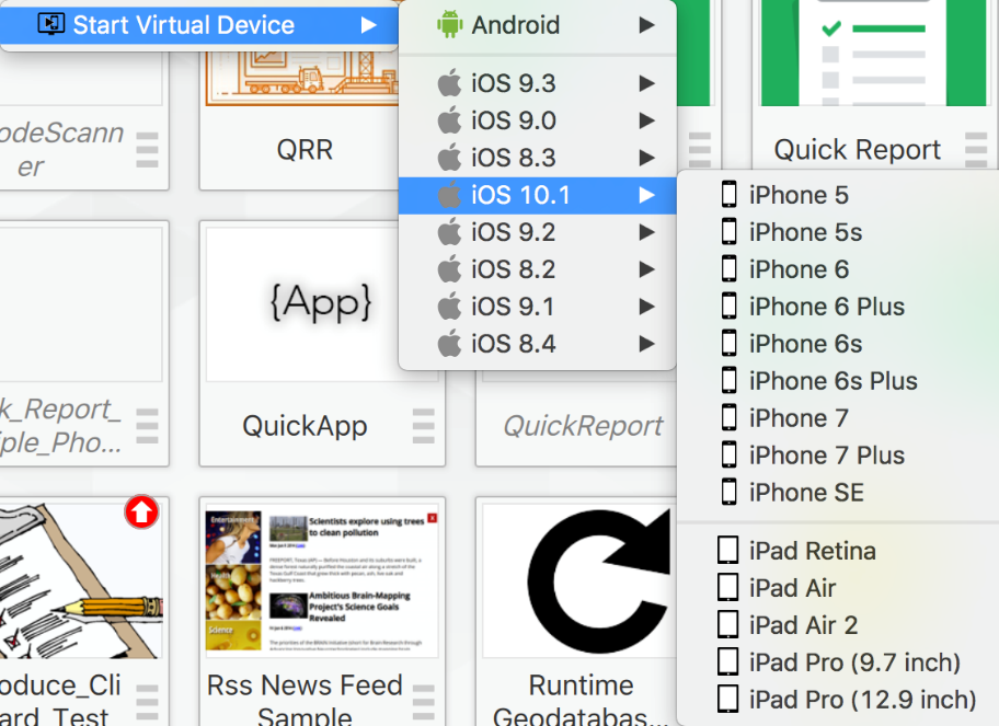

The simulator allows you to test apps with several SDK versions and operating systems. You can download additional simulator device images within XCode, open XCode and select Menu > XCode > Preferences > Select Components
After installing XCode, you can view a list of simulated devices when you click on the Virtual Device icon in AppStudio.
