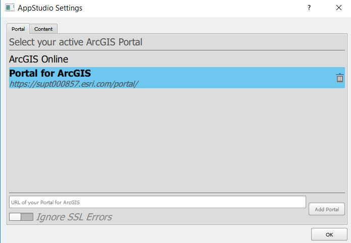

1. Click on the new Settings icon
2. By default, ArcGIS Online is configured. You can go ahead and add the portal url to the list. If you have many please choose the appropriate one.

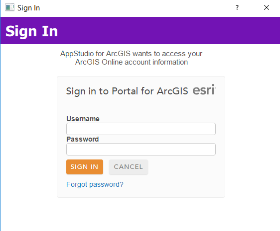

3. Now when you sign in to AppStudio for ArcGIS, you will be presented with the authentication screen of the portal. Something similar to the screen shown below (Note that each Portal might have a difference authentication set, you will see the same authentication screen as you would while signing in on a browser)

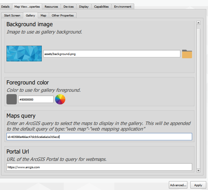

1) App hosted on your Portal and the content such as webmaps, feature services etc also hosted on your Portal for ArcGIS. For e.g. MapViewer application settings consuming webmap hosted on your portal would look like.
2) App hosted on your on-premises Portal for ArcGIS but the content is hosted on arcgis online. For e.g. MapViewer application settings consuming webmap hosted on arcgis online would look like.
3) App hosted on ArcGIS online but the content comes from your portal. In this case your application settings would be same as 1).

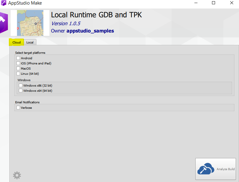

1. The whole point of supporting on-premises portal with AppStudio was the requirement that source code of the app cannot be hosted online in the cloud (in your own hosted ArcGIS orgnization). This also implies you do not want AppStudio service to have access to the app source code. Which then implies that our awesome Cloud Make infrastructure (which makes your life easier and does all the heavy lifting) cannot get to your source code to build the app(s). You still have local make to the rescue but you voluntarily take on the responsibility and the effort of building apps and having appropriate environment setup to build. Please refer to this documentation on Local make to get you started.
For e.g. When the application is hosted on arcgis online. You have options to build your executables using Cloud make and Local make
However, when the application is hosted on your end using portal. You only have an option for building using Local make
