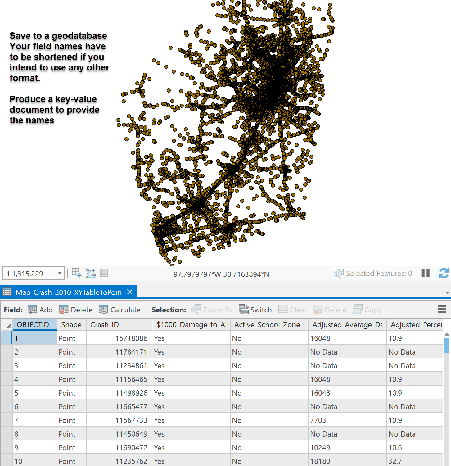

The data are fine... save to a file geodatabase since the field names won't allow for any other format (ie shapefiles).
I just use the XY to Point tool in arctoolbox, saved it to a geodatabase and you are done
