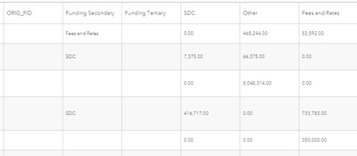

We have some of the same issues you do.
I added a field for primary, secondary, and tertiary funding sources. We indicated which source put in the most money. Then secondary got the was noted by the second most money. We have 3 primary funding sources SDC, Other, and Fees and rates I added how much was is taken from each funds.
Here is the table of we handle showing multiple funding sources:

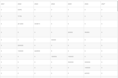

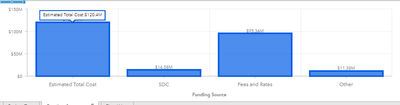

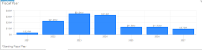

As for multiple years funding I added a few more fields and created a chart

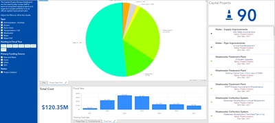

Here is what the final dashboard looks like. I have the map on another tab.
