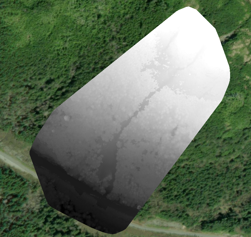

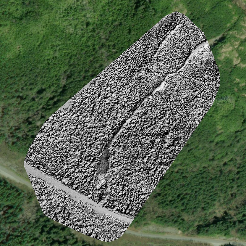

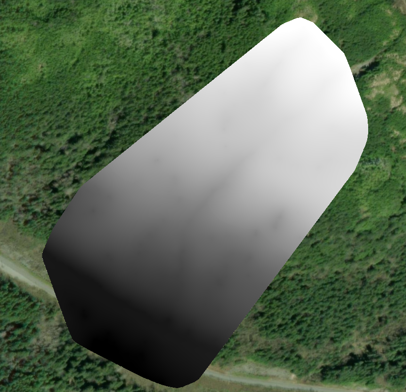

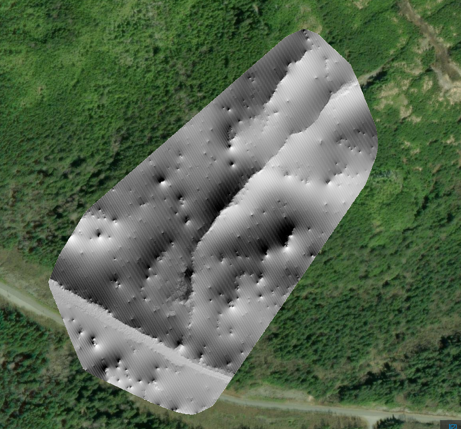

Hello! I just started using Site Scan and I'm definitely not used to working with aerial imagery, so bear with me. I'm having an issue where the DSM/DTM data looks different in Site Scan vs when I bring it into Pro. Here's what I'm seeing:
DSM in Site Scan:

DSM in Pro:

DTM in Site Scan:

DTM in Pro:
What can I do to get the Pro imagery to match what is shown in Site Scan? Any assistance is greatly appreciated. Thank you!
EllieHakariAK
Figured it out! I had to use the Hillshade tool in Pro to create a hillshade from the .tiffs. That solved the issue. Adding this in case other beginners run into the same issue!
