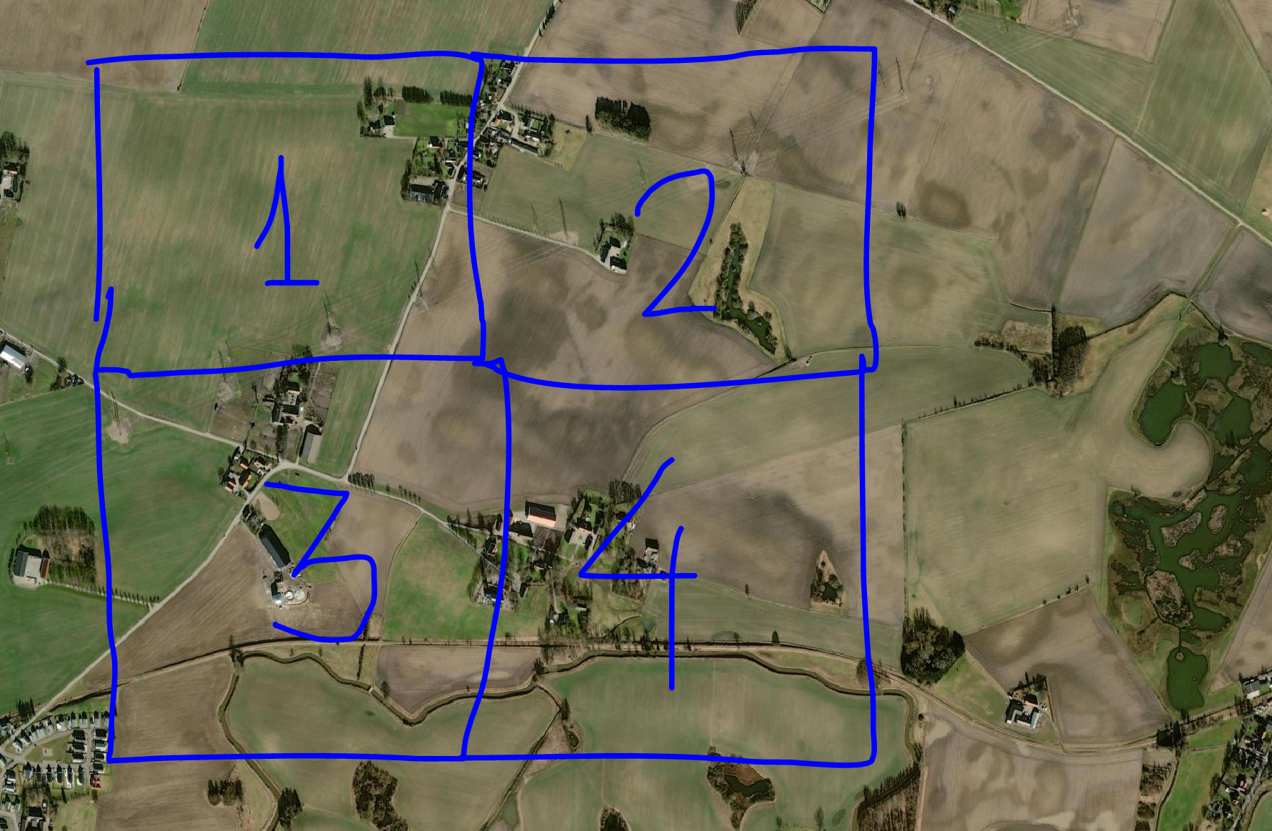

Does anybody know how to show in the same Site Scan dashboard orthomosaics from different flights of a project? . I mean, it could be inside of a mission. I have an orthomosaic (1) and I would like to show the surrounding missions ortho on the same dashboard  (2-3-4).

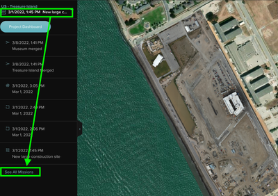

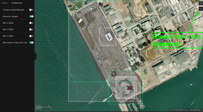

    • Use the "See All Missions" view:
      • From the mission 2D view, click the mission data and name,
      • At the bottom of the list, click "See All Missions"
      • Select the desired missions to display from the list on the left or by selecting their footprint on the max view. (Footprints can be hidden using the button in the upper-right of the screen)
